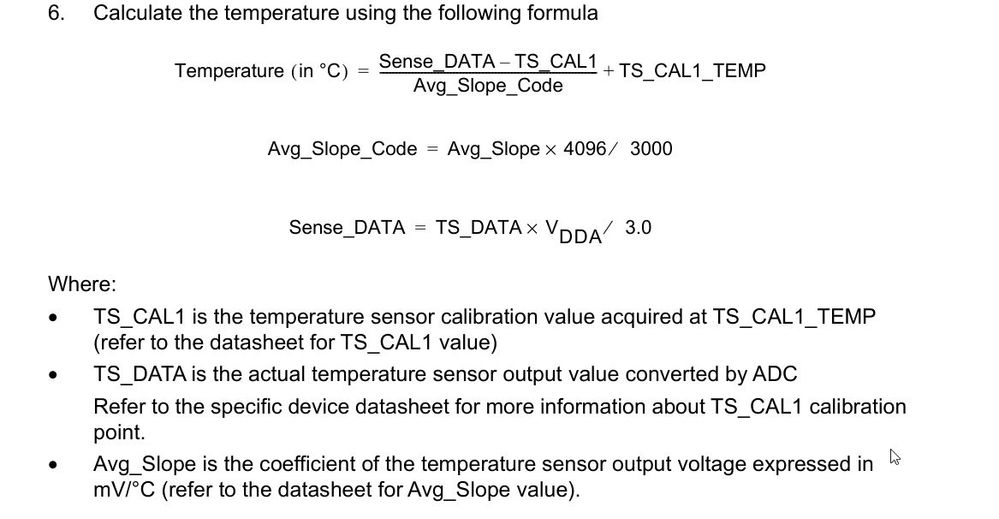

I'm using the internal temp sensor on a C011 chip *actually the STM32C0116 dev board) and trying to  get an approximate reading in C, using __LL_ADC_CALC_TEMPERATURE_TYP_PARAMS macro.
I understand that this won't be very accurate, but it seems that when I use the T_CAL1 value stored in ROM the result actually gets significantly worse. Here is my code:

My raw_value is 787. When I use the typical datasheet value of 760, I get a result of -20. If I use t_cal1 (which has a value of 1048) I get -134
What is going on? OK, I don't expect much accuracy, but using the internal cal value should at least make things better not worse?

I am just plugging numbers into the macro. In all honesty I spent a good hour trying to relate the macro to the datasheet without success. it is not even clear to me what reference is used internally for the temp sensor.

using the datasheet and trying to do it manually (screenshot below):
Avg Slope Code = 2.53 x 4096/3000 = 3.45
sense data = 787 x 3.3 / 3 = 866
TS_CAL_1 = 1048
Temp = ((866 - 1048) / 3.45) + 30 = -23
I am just putting the numbers into the equation, exactly as described, so something is incomplete or unclear here.

Well, the 787 you quote as raw value does indeed correspond to -20°C, according to the calculations given in the manual. Using the t_cal1 value it's -22.8
I would expect to see an ADC count of around 1030 at 25°C
  • Are you meeting the required minimum sampling time of 5µs?
  • Are you meeting the required start-up times given in the datasheet?
In addition to these:
  • Are you calibrating the ADC on startup, before it is used?

indeed, I think sampling time was the issue. I went back into CubdeMX, slowed down the ARC clock and the sampling setting to about 10us, and now I get results of about 70 degrees, which are believable.
I still cannot make sense of the supplied macro in the library, but if I do it myself, I get these numbers now.
