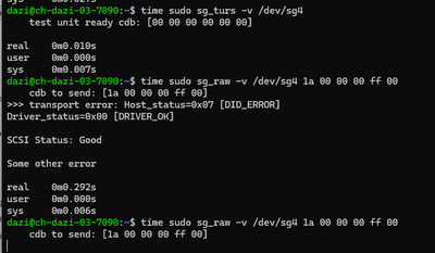

To reproduce the issue you can follow the steps below. If you are working on Linux, it is even simpler:
Optional step on Windows: open Power shell with Admin rights:
  1. Install usbipd
  2. usbipd list -> identify the bus ID
  3. usbipd bind --busid 6-7 --force -> this binds the port
  4. usbipd attach --wsl --busid 6-7 -> will attach usb port to WSL and start a server
On Linux / WSL (i choose ubuntu):
  1. lsusb -> identify you device
  2. dmesg | tail -20 -> also helps to find the device, for me it is /dev/sg4:
    2026-03-25 18_08_28-TmpWorkspace - STM32H7_MSC_CDC_Core_Src_main.c - STM32CubeIDE.png
  3. time sudo sg_turs -v /dev/sg4 -> will send a test message and should repport that a SD card is present
  4. time sudo sg_raw -v /dev/sg4 1a 00 00 00 ff 00 -> this will break the MSC and the device is not responding anymore
The second request with SCSI command 0x1A will never complete and the endpoint stalled and does not recover.
Best regards
Daniel
