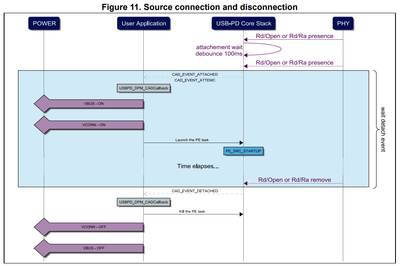

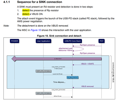

We need to control periodically VBUS as specified in UM2552  after USBPD_DPM_CADCallback, we need to launch the PE task and we control periodically VBUS.. Our documentation clearly explains how it should work !

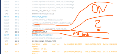

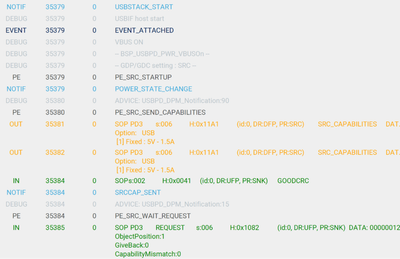

As I am running on a custom hardware I wasn't easily able to run STM32CubeMonitor-UCPD, but I managed to at least output the trace as text using the "Select Tracer Port" in the top right (however a txt is generated then instead of a .cpd). Hope this helps as well, otherwise I will need to dig deeper into that. Please find the txt attached.
Here you can see the issue as well: At timestamp 19773 VBus is enabled (which just does nothing in the dummy implementation attached to my first post) and immediately after at timestamp 19773 to 19778 three source capabilities messages are sent out. But in between BSP_USBPD_PWR_VBUSGetVoltage is never queried...

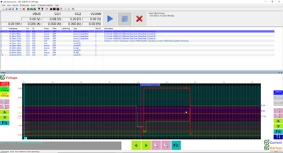

In an external trace tool you can see the same: Without VBus enabling (obviously as in this minimal example I am doing nothing to enable VBus) Source Capabilities are spammed out on CC lines...

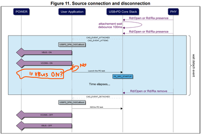

Regarding your first point: I don't really get your point. In my example I am source and not sink. So I guess the relevant timing diagram from UM2552 would be this?
In this diagram there is also nowhere mentioned, that actually for USB PD Compliance you would want to wait between VBUS-ON and probably the launch of the PE Task (or you would need to wait in the launched PE Task) until VBus really is there. So I would expect something like this:
or alternatively the waiting part in the PE Task.
What am I missing?
I can see that the headline of the implementation in my picture is "User Application". Here I have just been using the default generated code by CubeMX:

 VBus is enabled in USBPD_DPM_UserCableDetection and immediately after DPM_StartPETask starts the PE Task. Do I have to add a wait manually in here? (actually you don't want to pause the execution in a callback so I guess I would have to do some state machine magic here and remember to start the PE Task once VBus is on...)
Would a handling inside PE Task (or somewhere else where there is already a state machine) not be more elegant?

  1. Regarding VBUS checking before starting the PE task:
    The USB PD stack relies on the CAD state machine to monitor VBUS presence through the power interface functions like BSP_USBPD_PWR_VBUSGetVoltage(). The PE task is triggered by the CAD callback on attach events, but internally the CAD state machine verifies VBUS status before allowing the PE state machine to proceed. This means the stack does not block or wait explicitly before starting PE; instead, it depends on accurate VBUS detection in the CAD layer.

  3. On the figure 11 in UM2552 and compliance:
    In my understanding, USB PD specification does not explicitly require a delay between enabling VBUS and starting the PE task. Instead, it expects the CAD layer to handle VBUS detection asynchronously. Blocking inside the CAD callback to wait for VBUS is not recommended and would complicate the state machine.
So what is the recommended approach?
You should implement the power interface functions properly so that BSP_USBPD_PWR_VBUSGetVoltage() returns the actual VBUS voltage. This enables the CAD state machine to detect VBUS presence correctly and only then start the PE task. This approach is cleaner and aligns with the stack’s design.
The USBPD example firmware you already mentioned for STM32H573I-DK fully implements these power interface functions and integrates with STM32CubeMonitor-UCPD for trace and debugging. I recommend reviewing that example to understand how VBUS detection and PE task triggering are coordinated. Also, this wiki  STM32StepByStep:Getting started with USB-Power Delivery Source - stm32mcu and Introduction to USB Power Delivery with STM32 - stm32mcu can help you understand better the stack.

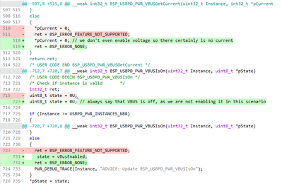

  2. Yes in the minimal example my PWR functions were barely populated, but breakpoints in there never hit and e.g. looking at that mentioned USBPD_PWR_IF_ReadVA() function, there is not a single use in the project.
    Nevertheless I have now also populated the rest of the PWR functions (with stubs) without any difference:
    Breakpoints in most of the new ones also never hit. Obviously the implementations are stubs but when VBus does not turn on and VBUSGetVoltage always return 0V then it should never send SRC Capabilities, right? Even if it would magically just not show the call to VBUSGetVoltage in the trace. Or is there a different function that I need to change that is used to determine VBus voltage?

  1.  Even with PWR Interfaces implemented nothing has changed (maybe I missed a function, that's why I added the diff images)
  2. That nothing changed is expected (from my point of view) as the USBPD_DPM_CADCallback implementation enables VBUS and right after starts the PE Task
  3. Even with that BSP_USBPD_PWR_VBUSGetVoltage implemented to return BSP_ERROR_NONE and 0V it seems to be never called between enabling VBUS and starting PE Task

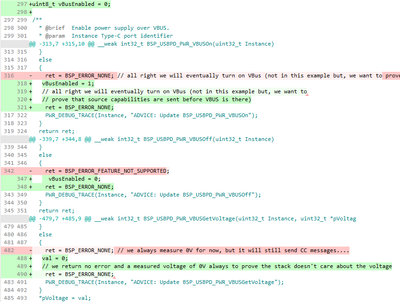

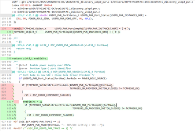

I got a STM32H573I-DK kit, opened the respective USBPD_SRC example in STM32CubeIDE and could reproduce the issue with minimal changes only to delay the enabling of VBus (which resembles the delay a DCDC converter takes to switch to the new voltage setpoint):
Drivers/BSP/STM32H573I-DK/stm32h573i_discovery_usbpd_pwr.c:
Utilities/GUI_INTERFACE/gui_api.c:
It shows the exact same problem:

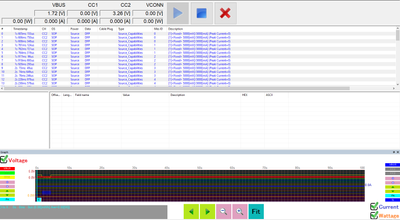

The first Source Capabilities Package is sent where the blue vertical line is in the graph (marked with "#0 Source_Capabilities").
This is why USB Compliance Tests of our hardware fail...
Now after recreating it using the Discovery Board, I am clueless on what to do. I guess the problem lies in the compiled binary of the ST USB Library?
@FBL if there is no more hints from your side, could you please connect me with the respecive expert? I certainly need support on this here.

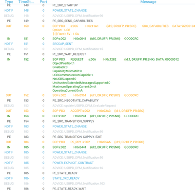

  2. Here is my log using the H573-DK board and the example firmware SRC FBL_4-1760109456330.png

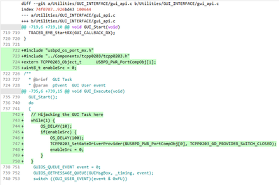

  3. The delay you introduced in tracer GUI API led to lose the detection of COM port in UCPD Monitor tool. Here explicit contract using the examples firmware H573-DK as source and a G0+x-nucleo-DRP as sink
  4. To learn more about compliance tests you can check docs here: x-cube-tcpp/Documentation at main · STMicroelectronics/x-cube-tcpp
  5. About, the first Source Capabilities sent where the blue vertical line is in the graph (marked with "#0 Source_Capabilities") , according to section 6.6.3.3 tFirstSourceCap from USB PD Specification, rev3.2, Version 1.1, 2024-10, the problem here is that it should be within tFirstSourceCap, could you share your schematics?
  6. In discovery kit, I've manually inserted a delay of 100ms between
int32_t BSP_USBPD_PWR_VBUSOn(uint32_t PortNum)
  int32_t ret = BSP_ERROR_NONE;
  /* Check if instance is valid */
  if (PortNum >= USBPD_PWR_INSTANCES_NBR)
    ret = BSP_ERROR_WRONG_PARAM;
  else
#if (USE_BSP_USBPD_PWR_TRACE == 1)
    BSP_USBPD_PWR_TRACE(PortNum, "-- BSP_USBPD_PWR_VBUSOn --");
#endif /* (USE_BSP_USBPD_PWR_TRACE == 1) */
    /* Port Role is now SRC : Close Gate Driver Provider */
    if (USBPD_PWR_Port_Status[PortNum].PwrRole == POWER_ROLE_SOURCE)
        HAL_Delay(100);
      if (TCPP0203_SetGateDriverProvider(&USBPD_PWR_PortCompObj[PortNum],
                                         TCPP0203_GD_PROVIDER_SWITCH_CLOSED) != TCPP0203_OK)
        ret = BSP_ERROR_COMPONENT_FAILURE;
      BSP_USBPD_PWR_TRACE(PortNum, "-- GDP/GDC setting : SRC --");
 Here is the trace, we can see that the source capabilities is delayed of 101ms of VBUS ON;
36	CAD	12904	0	USBPD_CAD_STATE_ATTEMC
37	NOTIF	12904	0	USBSTACK_START
38	DEBUG	12904	0	ADVICE: USBPD_DPM_Notification:104
39	EVENT	12904	0	EVENT_ATTEMC
40	DEBUG	12904	0	VBUS ON
41	DEBUG	12904	0	-- BSP_USBPD_PWR_VBUSOn --
42	DEBUG	13005	0	-- GDP/GDC setting : SRC --
43	PE	13005	0	PE_SRC_STARTUP
44	NOTIF	13005	0	POWER_STATE_CHANGE
45	DEBUG	13005	0	ADVICE: USBPD_DPM_Notification:90
46	PE	13005	0	PE_SRC_SEND_CAPABILITIES
47	OUT	13007	0	SOP	 PD3	s:006	    H:0x11A1    	(id:0, DR:DFP, PR:SRC) 	SRC_CAPABILITIES	DATA: 96900102	Option: 	DRD	 [1] Fixed : 5V - 1.5A /
Without this delay, source capa are sent in 1ms after Vbus on as you can see in the trace
20	EVENT	21310	0	EVENT_ATTEMC
21	DEBUG	21310	0	VBUS ON
22	DEBUG	21310	0	-- BSP_USBPD_PWR_VBUSOn --
23	DEBUG	21311	0	-- GDP/GDC setting : SRC --
24	PE	21311	0	PE_SRC_STARTUP
25	NOTIF	21311	0	POWER_STATE_CHANGE
26	DEBUG	21311	0	ADVICE: USBPD_DPM_Notification:90
27	PE	21311	0	PE_SRC_SEND_CAPABILITIES
28	OUT	21312	0	SOP	 PD3	s:006	    H:0x11A1    	(id:0, DR:DFP, PR:SRC) 	SRC_CAPABILITIES	DATA: 96900102	Option: 	DRD	 [1] Fixed : 5V - 1.5A /
