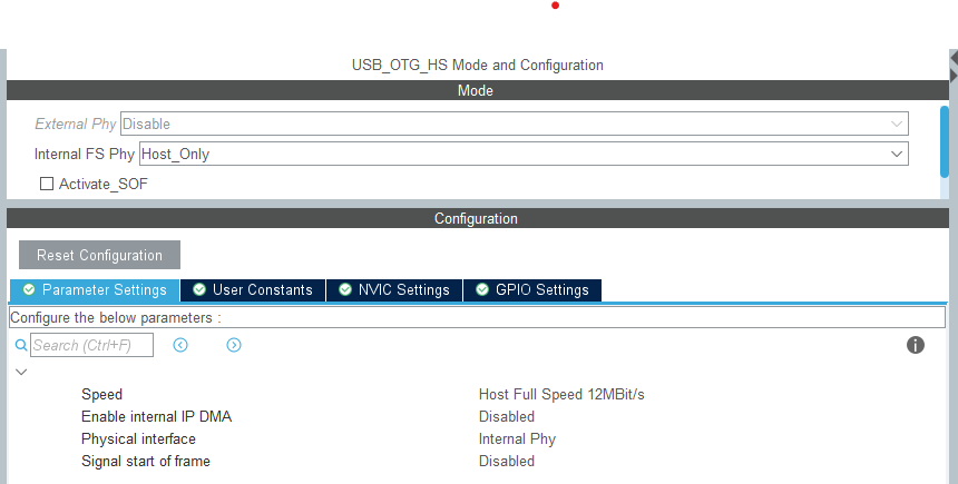

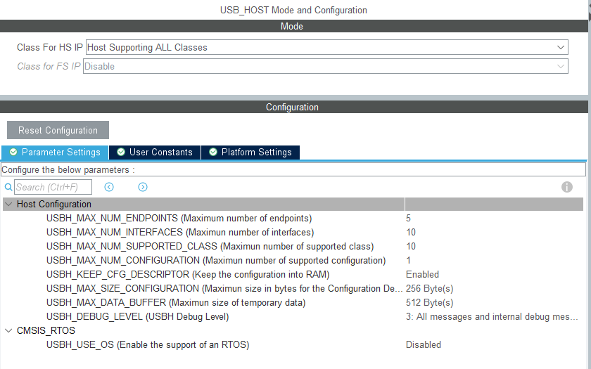

I have a NUCLEO-H7A3ZI-Q setted as USB Host. I connect a MIDI Keyboard and the Host start the communication, gets all the descriptor and then start the parsing phase to define the device descriptor, the configuration descriptor, the interfaces descriptors and then the END POINTS descriptors.
It works, but it can't parse the last END POINT so the code never get out of a while loop.
Before showing the code and the configuration settings, I have to say that I have used an USB sniffer to check that the end point really exist. It exist and is normally read by the PC. So it's not a device problem.
Ok, let's see the settings
0693W00000KdDN1QAN.png0693W00000KdDM3QAN.pngHonestly except for the buffer size (which is at the maximum 256 byte) i think that there aren't wrong settings here because it communicates.

I do not believe that much in those two possibilities but they are the only ones that come to mind:
  • The MAX SIZE CONFIGURATION BUFFER is too small
  • The Middleware is bugged somewhere
I mean, I have connected several other USB devices (Pen Drive, Mouse, keyboard even a Microscope) and from all of them I got the entire descriptors.
Sounds likely. What is the total length of Configuration descriptor in question?

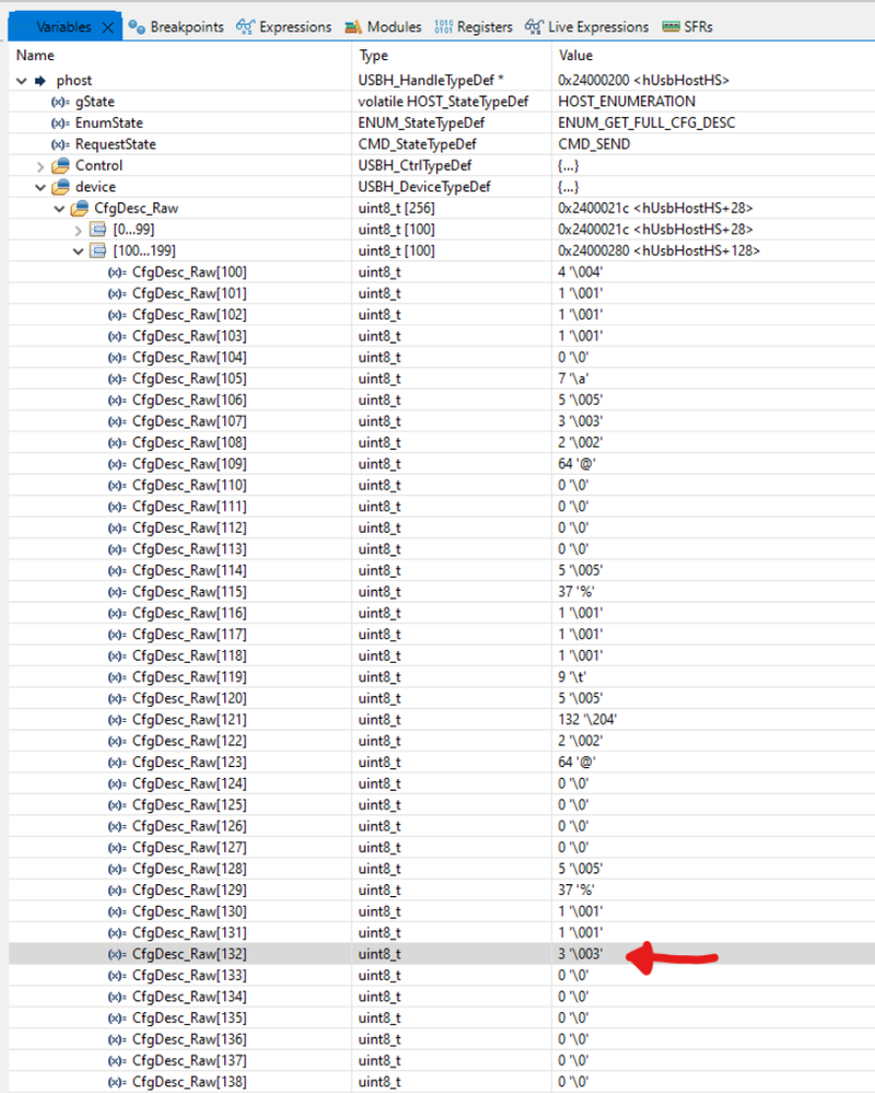

Hi @Community member​
Below you can see the raw data descriptor. It seems to be long only 132 byte.
0693W00000KdK1MQAV.pngCan you tell me if I'm showing to you the correct raw data?

waclawek.jan
Bytes 2 and 3 form a 16-bit value, wTotalLength, determining the length of complete configuration descriptor "assembly", and it's indeed 133 bytes, so that's OK.
Descriptors you've marked "I don't know what it is" are class-specific descriptors - the first interface is HID, so look into the HID class documentation for that; the other interfaces are Audio class, again look into the Audio class documentation to find out what those are.
What may happen here is, that the Audio class redefines the Endpoint descriptor, extending it from the standard 7 to 9 bytes. In the code snippet you posted above this is reflected in
pdesc->bLength = 0x09U;
but the descriptor you've posted uses 9-byte EP desciptors also for subclass 3. Now how does this exactly lead to failure to parse I don't know, the key is in the functions called from that snippet and I don't use Cube and have no intention to debug it myself.
Ok, after several attempt i have discovered that if I define a MIDI class descriptor, the parsing operation can recognize the EP properly. At the end I have been able to complete the USB interfacing and create the pipes. It works smoothly but at the end I have understand that USB library provided by ST is only a starting point (a good starting point) to develop your own code.
@Community member​, thank you very much for the hints!
