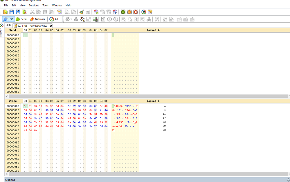

Hi, i'm trying to control a barcode printer with STM32F105VCT6 with USB. The printer is godex EZ-1005. When i plug usb cable usb state comes to APPLICATION_START from APPLICATION_IDLE.
According to this document. (Page 6) i need to send Standard Requests and Class-Specific Requests. I looked with usb analyzer program while printing with pc but i couldn't analyze this raw data 0693W00000Bbyy5QAB.png
I'm not familiar with usb protocol so i don't know how to send printer comands to printer over usb. I coundn't find any example or guide.
Do you have any solution or suggestions?

Unfortunately, the USB HOST printer class is not supported by ST until today. Maybe it will be supported in the future.
Otherwise, take a look at the following links. They may help you.
https://www.openstm32.org/forumthread6673
https://community.st.com/s/question/0D50X00009XkaNSSAZ/usb-printer-class
