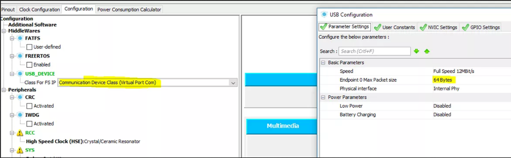

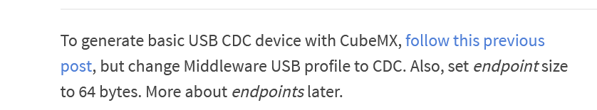

Please review the following webpage and test again using the 64 byte recommendation for the EP definition:
https://damogranlabs.com/2018/02/stm32-usb-cdc/
A complete project file is posted on the landing page.
Please post your update after testing.
BPR
Actually i'm using the same configuration as showed in this site, but it is not working..

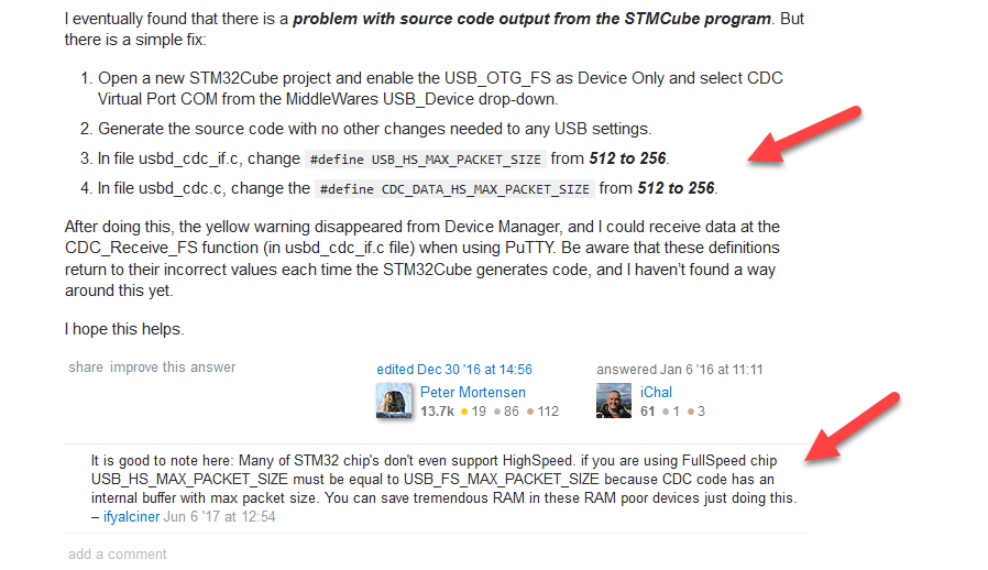

Hi. Please review the following thread,
https://stackoverflow.com/questions/33549084/stm32cubemx-usb-cdc-vcp
and special notes:
Please post your update after this review. If you have done all of these required steps, please post your project / code with details of how you are testing. Include the terminal program being used or whatever to send data to this USB CDC device.

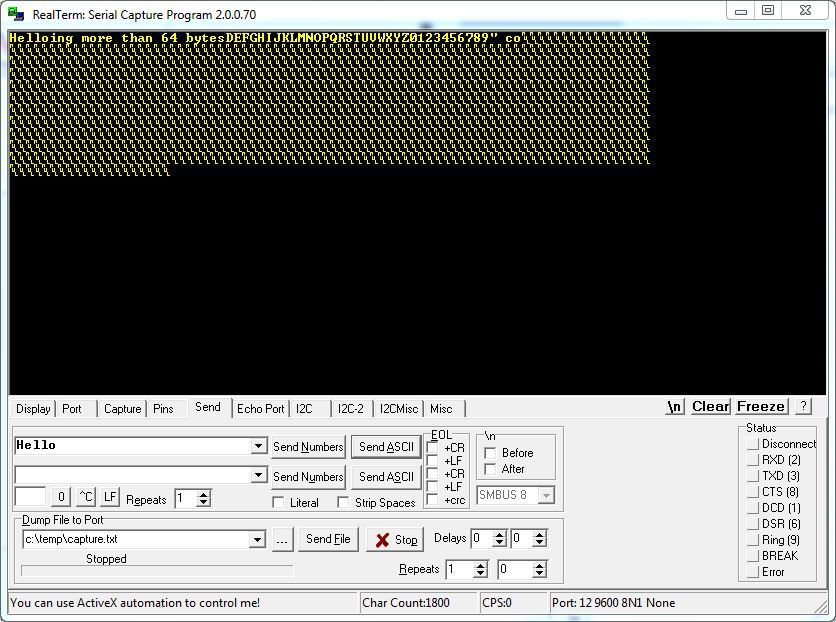

Case 1
After reset i sent "Hello" to Device and it printed some Null characters after Hello.

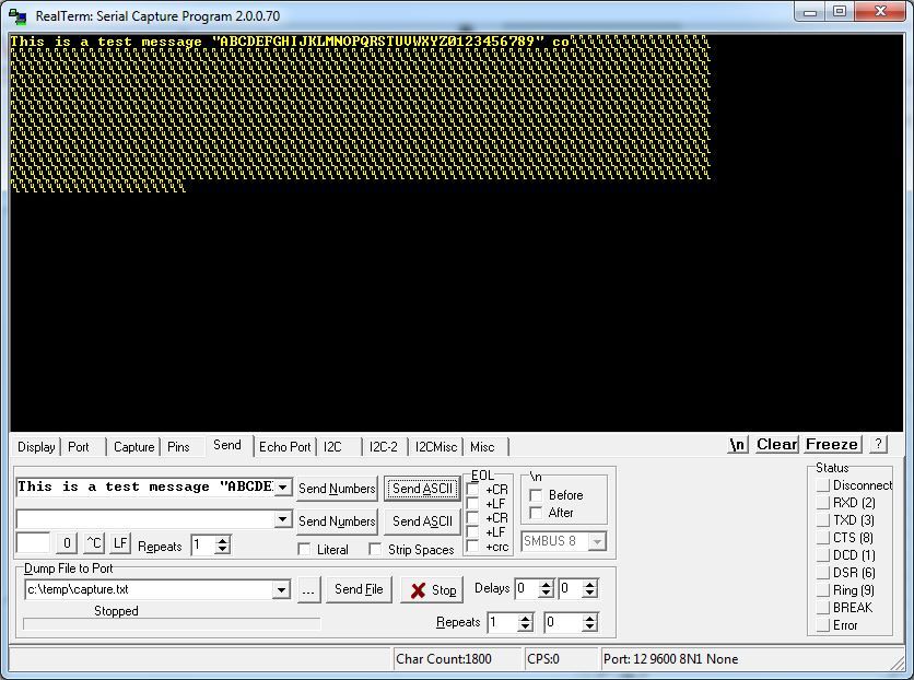

Case 2
Sent "This is a test message "ABCDEFGHIJKLMNOPQRSTUVWXYZ0123456789" containing more than 64 Bytes" and it printed only 64 bytes with some Null characters after message.

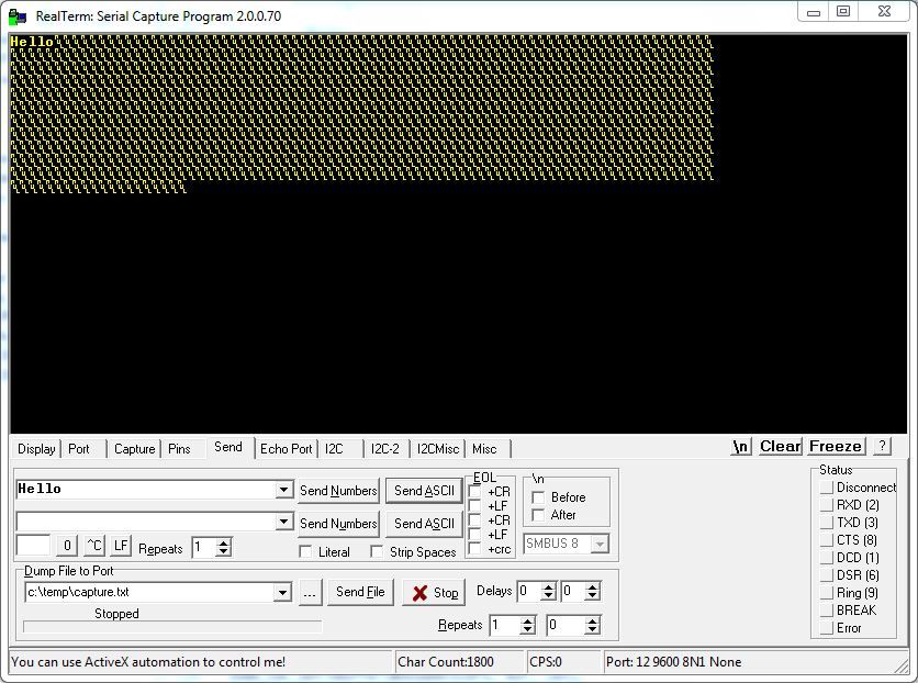

Case 3
Again i sent "Hello" text but this time it printed Hello with part of previous message.
