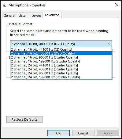

Hi all,
I am using a STM32H7 and I implemented a composite usb device (CDC + AUDIO recording) using IAD interface descriptor.
I can successfully configure the audio interface as type I PCM (I tested both 16 and 32 bit), but if I try to configure the audio as type I IEEE_FLOAT windows does not recognize the microphone (the device is still present in device manager under 'sound devices', but there is no input device under 'Audio inputs and outputs'.
I just changed the wFormatTag field of the descriptor, leaving the bSubFrameSize=4 and bBitResolution=32.
Have I to change something else?
Thank you in advance,
regards

Sounds like you have misunderstood something. WASAPI exclusive mode supports those formats, which the particular hardware and driver supports, because it doesn't do any processing. That's the whole point of exclusive mode! On the other hand, the WASAPI shared mode does the mixing and resampling and therefore has to have some common format - a single precision float.

As I said - WASAPI exclusive mode supports those formats, which the particular hardware and driver supports, because it doesn't do any processing. PCM 32-bit is rarely supported, because it just wastes bandwidth with no practical usefulness. Maybe the particular device is something like this, while other devices can be like this. As you can see, the Windows sound properties show the formats supported. In addition you can install AIMP and check/test all of the Windows audio interfaces and supported formats.

My device supports only 2 channels, 32 bit, 48000 Hz and cannot be open in exclusive mode by wasapi.

It doesn't matter at what some particular software fails. I already told how to check and test the capabilities with a reliable well known free software - use Windows sound properties and AIMP.

I already checked the capabilities of my device with Windows, that it is not the point.
I try to explain better what I am trying to do:
- if I compile my code in order to appear as microphone working in PCM 16 bit, I can start a recording with WASAPI in exclusive mode setting it as PCM 16 bit as well;
- if I compile my code in order to appear as microphone working in PCM 32 bit, I cannot start a recording with WASAPI in exclusive mode setting it as PCM 32 bit as well.
