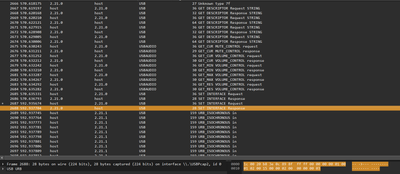

I'm a USB newbie and am trying to use the STM32F411CEU6 as a USB mic. I'm currently using FreeRTOS (cmsisV1) and the Cubemax USB library. My device currently enumerates normally, but when the host sends a URB_ISOCHRONOUS_IN request, my MCU won't handle it properly (according to SWD and serial port debugging, I found that the MCU won't even enter the OTG_FS_IRQHandler interrupt when the host sends this request). This has been bothering me for a long time. Here are my descriptors and some configuration code:

}WireShark result:
Solved! Go to Solution.

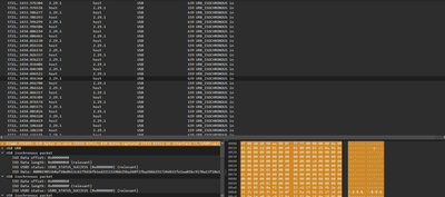

2025-09-03 2:10 AM

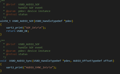

I tried marking all USBD_ClassTypeDef methods as serial output, like this:
Through the serial port output, I found that when the host sends the URB_ISOCHRONOUS IN request, although the MCU does not enter the USBD_AUDIO_DataIn function, it will enter the USBD_AUDIO_IsoINIncomplete function. After I added the function of sending data to the FIFO, the USB host can receive the data smoothly:

* @brief USBD_AUDIO_IsoINIncomplete
* handle data ISO IN Incomplete event
* @PAram pdev: device instance
* @PAram epnum: endpoint index
* @retval status
static uint8_t USBD_AUDIO_IsoINIncomplete(USBD_HandleTypeDef *pdev, uint8_t epnum)
uart2_print("ISO_IN_In\r\n");
FillAudioFrame();
USBD_LL_Transmit(pdev, AUDIO_IN_EP, usb_buf, AUDIO_IN_PACKET);
return USBD_OK;

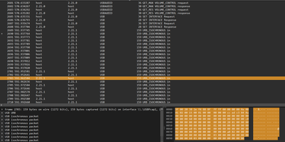

}WireShark:
I hope to give some inspiration to other confused people. Thank you to everyone who is watching this post.

@Pete_Griffin wrote:trying to use the STM32F411CEU6 as a USB mic.
Your title says USB speaker.
A speaker would not be expected to work as an input device - would it?
2025-09-03 2:03 AM
Sorry,I was confused by the error...... but thank you for your prompt response, I have solved the problem through my tireless efforts! :)
static void FillAudioFrame(void)
float freq = 1000.0f;
float amp = 10000.0f;
for (int i = 0; i < 48; i++) {
int16_t sample = (int16_t)(amp * sinf(2.0f * 3.1415926f * freq * sample_index / 48000.0f));
usb_buf[i*2] = sample & 0xFF;
usb_buf[i*2+1] = (sample >> 8) & 0xFF;
sample_index++;
if (sample_index >= 48000) sample_index = 0;
* @retval status
FillAudioFrame();
return USBD_OK;
}WireShark:
