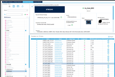

Hi @T_Hamdi thank you for the support,
I reattached the project, I hope this is OK.
I started taking inspiration from the "Ux_Host_MSC" example project but deleting the USBPD software pack:

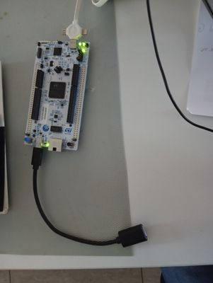

hallo @T_Hamdi ,
I connected a jumper in JP2 USB_USER, to provide the power to the device. 5V_USB_LED LD7 is also ON.

I thought the power was provided to the usb stick because when I plugged the usb stick, it lights up. I take 5V from STLK (JP2 STLK) and give to the USB from JP2 USB_USER.
So, how can I setup the HW to be able to develop my host msc applicaton? Is it possbile?

Capocc
Thank you @T_Hamdi
"the board cannot supply power directly through the USB Type-C port", this is excactly what I was trying to do. I will connect an external board to the CN12 connector using the pins PA11 and PA12 to test my application.
