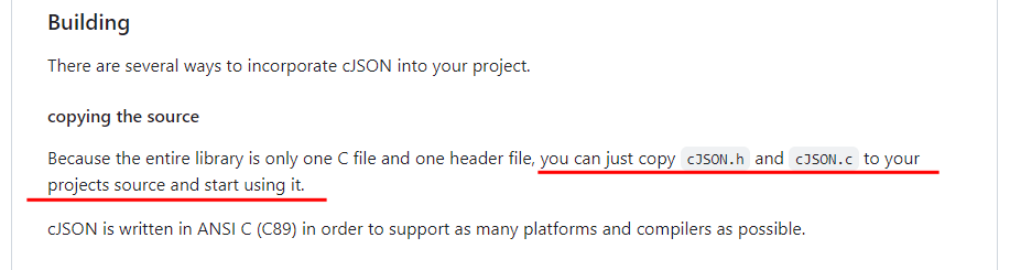

Is there any cJSON library available for STM32?
‎2024-03-07 5:44 AM
@srikanthpalvai wrote:Is there any cJSON library available for STM32?
Why would it be in any way specific to STM32 ?
Surely, it's just about parsing text - which isn't going to rely on anything STM32-specific?
You can simply dump the source into your project:
https://github.com/DaveGamble/cJSON

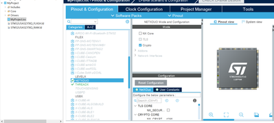

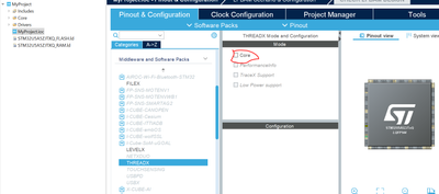

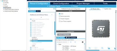

After enabling the core, Netxduo is getting enabled bu why do I enable threadX first?
I found crypto here but it's not the mbed-crypto
@STea Could you please give me some inputs to my reply's

Hello @srikanthpalvai ,
First of all sorry for the delay.
answering your requests now :
- "After enabling the core, Netxduo is getting enabled bu why do I enable threadX first?"
NetX Duo assumes the existence of ThreadX and depends on its thread execution, suspension, periodic timers, and mutual exclusion facilities. you can get more indepth details on this in this link .
- "i found crypto here but it's not the mbed-crypto"
NetX Duo Crypto Module is a lightweight cryptographic library that is designed specifically for use with NetX Duo TCP/IP networking stack. It provides a set of cryptographic functions that are optimized for use in embedded systems with limited resources. The NetX Duo Crypto Module supports a range of cryptographic algorithms, including AES, DES, SHA-1, SHA-256, and HMAC.
MbedTLS is not integrated by default in CubeMX so you need to add it to your project manually .
this can be done by adding the source file needed to your project as well as the necessary includes or you can build a static version of the Mbedtls library and use it with static link.
see the following link for more details
Porting Mbed TLS to a new environment or OS — Mbed TLS documentation (mbed-tls.readthedocs.io)
this can be quite challenging so i recommend you stick with the Crytpo module for Netxduo which offer a very similar functionality to the MbedTLS library .
