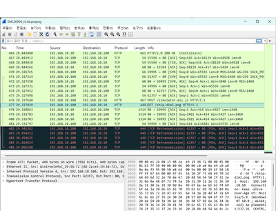

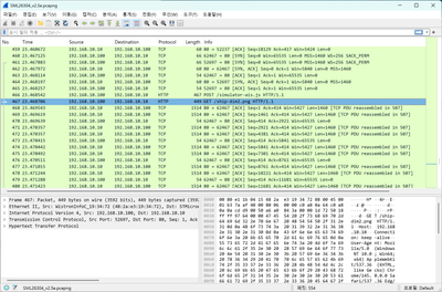

I am using below the libraries with my project.
STM32Cube_FW_H7_V1.12.0 (STM32H7xx HAL 1.10.0)
- LwIP V2.1.2, FreeRTOS V10.2.1, 2017 - ethernetif.c
And I designed the HTTP Server with STM32H743ZIT6.
It is very well operate.
And I updated the libraries such as STM32H7xx HAL 1.11.5 recently.
- LwIP V2.1.2, FreeRTOS V10.3.1, 2022 - ethernetif.c
All normal operations are functioning properly. (TCP, UDP)
However, an errors is occurring in the HTTP Server.
I implemented it by referenceing the LwIP_HTTP_Server_Socket_RTOS example from the STM32H7 HAL repository.
When approximately two files are requested simultaneously in a Web Browser, LwIP becomes unresponsive.
(Ethernet Event Handler is running when LAN cable Unplug and Plug)
(capture packets in old version)
(capture packets in new version)
There are no changes to the application. (httpserver_socket.c)
But, these error continue to appear.
I would appreciate any helpful advice.
