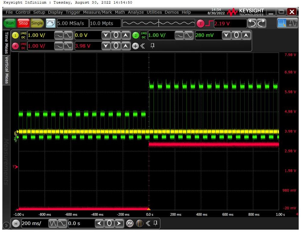

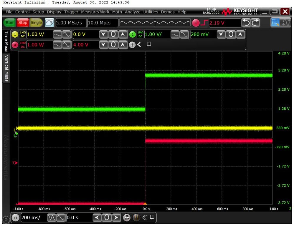

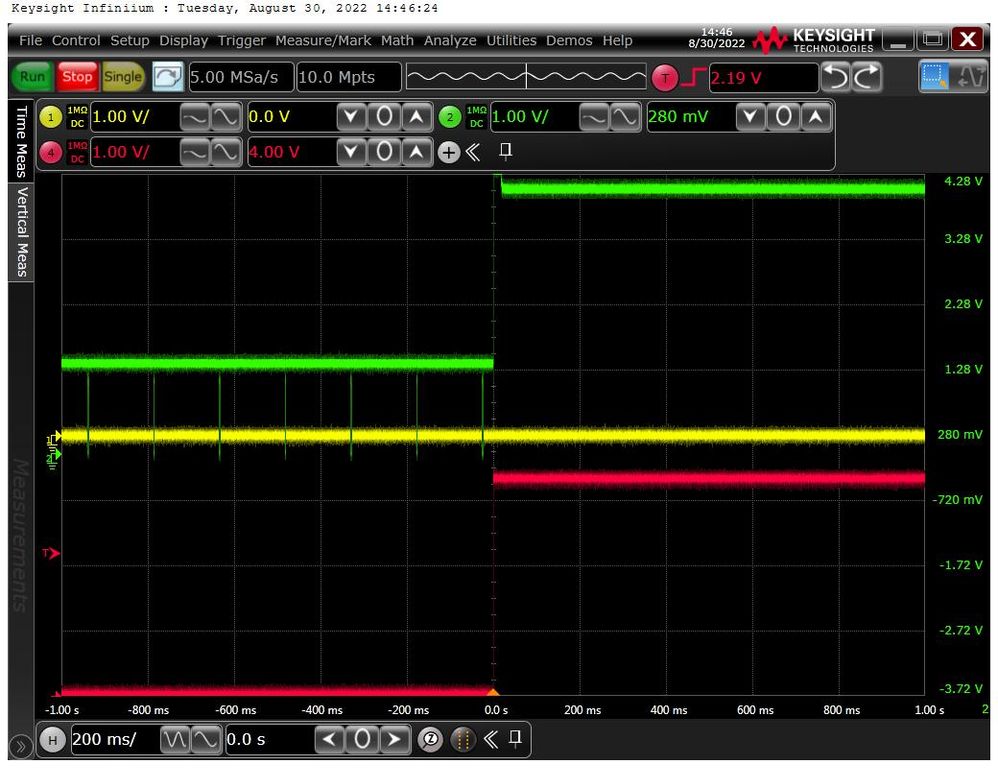

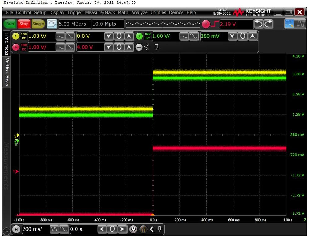

In Yellow and Green: CC1c and CC2c, in red VCC & DB\
I can observe the expected behavior: when VCC & DB\ is high, CC1x and CC2c are pulled up to 3V.
- When VCC & DB\ is driven by a GPIO in push-pull mode
- Or when VCC & DB\ are driven by an external power supply (min 2.4V typical in my bench)
I did the same removing Rp and connecting the board to a SRC1M1 X-NUCLEO
I can observe the expected behavior: when VCC & DB\ is high, CC1x is pulled up to 3V.
