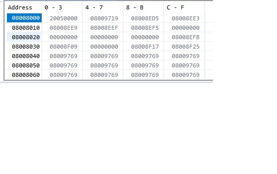

I develop a software using delay (and do Systick resource). This software works fine when it's mapped @0x08000000 and using BOOT_ADD0.
But, when I maps it @0x08008000 and use BOOT_ADD1, no Systick raises !

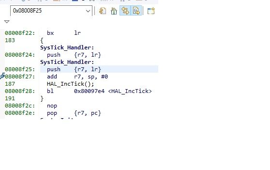

@0x0800003C and @0x0800803C I have the address of the systick_handler (handler incrementing a static variable on each IT at 1ms).

This values seem to be good.
when I look the flash memory address corresponding to the 0x0800803C content, it correspond to the systick_handler !
The problem isn't there.

ABITT.1
OK
@0x0800803C contains 0x08008F25...
and this address location correspond to the systick_handler...

What value does the SCB->VTOR register contain?
