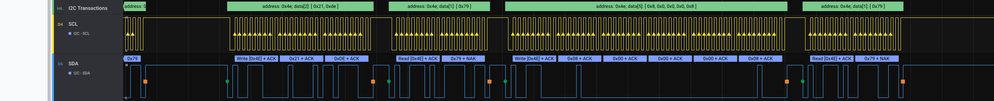

On the I2C protocol side, everything seems fine indeed, the bootloader responds with ACK
write to 0x4E ack data: 0x21 0xDE
read to 0x4E ack data: 0x79
write to 0x4E ack data: 0x08 0x00 0x00 0x00 0x20
But the execution hasn't switched to the user code, as the LED isn't blinking.
