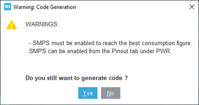

every time i update the code on the IOC file this message comes up
when i refer to the power this option doesn't exist
I noticed this option is available when the secure zone is disabled

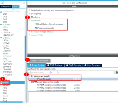

Hello @JulioAndrade
You can activate SMPS power supply by following steps in the attached screenshot.
I hope I have answered your question.
