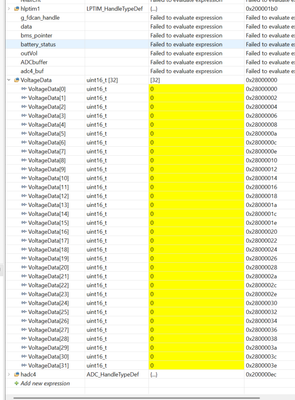

I create LBPAM application which continuously convert ADC4 data channel 22 (PC4) of STM32U575 VGTX.
I add HAL_DBGMCU_EnableDBGStopMode(); so I can debug in stop mode. I run LPTIM1 and ADC4 before going to STOP mode. I also move VoltageData buffer to SRAM4 uint16_t VoltageData[32] __attribute__((section(".sram4")));
LPBAM configuration contains one queue in Circular mode and only one node for ADC4 conversion.
After enter stop mode 2, no adc4 trigger, and VoltageData always is 0.
I attach my configuration so you guy can check it.
Thank you.

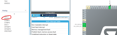

The posted code doesn't use ADC4 at all as far as I can tell. No MX_ADC4_Init call. No other calls in main().
In the IOC file, ADC4 is not enabled.
Am I missing it somewhere?

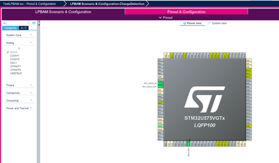

@TDK I configure ADC4 in LPBAM configuration.
I run ADC4 in MX_ADC4_Init() (LPBAM/ChargeDetection/lpbam_chargedetection_volmealoop_config.c)
