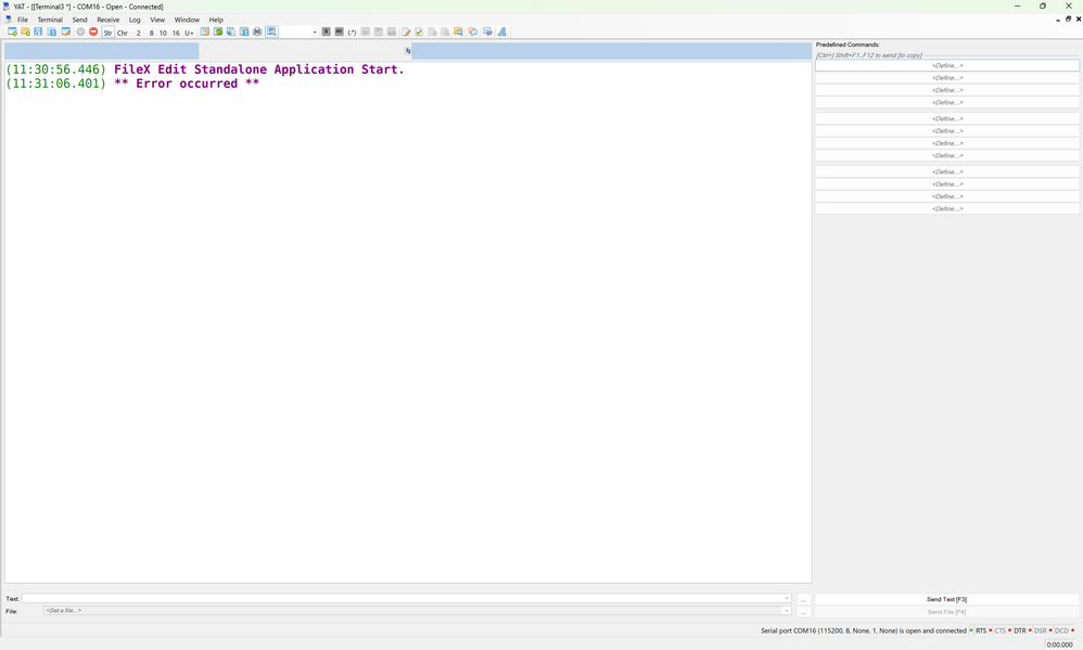

Hi, i want to use STM32U385RG (NUCLEO-U385RG-Q) to read and write files on SD using SDMMC (1 bit mode) interface, with FileX in standalone mode. I've successfully tested Fx_File_Edit_Standalone (SRAM) example and SD_ReadWrite_DMA (1 bit mode) example.
Following my MX_FileX_Process function:

The code fail on fx_media_open returning Error_Handler after 10 seconds timeout.
image.pngWhat is the problem?

Before calling fx_media_open(), try formatting the SD card with fx_media_format(). This ensures the card has a valid FileX/FAT file system and can prevent the timeout you’re seeing if the media is unformatted or corrupted.

Hello .@Saket_Om, thank you for the answer I formatted the SD card (and checked it again) before connecting them with nucleo, the result is the same.
Comparaing Fx_File_Edit_Standalone (SDMMC1) example for STM32U575I-EV with Fx_File_Edit_Standalone (SRAM) exaple for NUCLEO-U385RG-Q I've noticed that in the first example, I can enable the interrupt for SDMMC1 (NVIC Settings tab) while in the second example the NVIC Settings tab doesn't exist in SDMMC1 configuration. Could this be the problem?
Thank you.

Hello @alessandromauro ,
During debugging, could you please share the exact return status from fx_media_open() (the error value) before Error_Handler is called?
