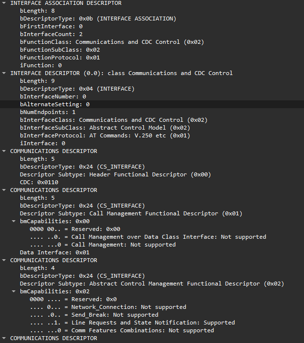

Hi @FBL
Found in attachment wireshark capture of three configuration cdc only, uvc only, cdc+uvc.
I zip the prohect too, change define at the top of file usbd_conf.h to change configuration.
I see now enumerate cdc-uvc seem's right but only cdc is view by windows and functionnal, not the uvc.

Hi @sebastien.marion,
Thanks for sharing the traces and project.
From the USBPcap/Wireshark capture, the CDC+UVC configuration descriptor that Windows receives is structurally almost correct, but there is a descriptor inconsistency in the Video interface collection that explains why only CDC is exposed.
In your composite configuration: the UVC IAD correctly groups:
  • Interface 2: VideoControl (VC)
  • Interface 3: VideoStreaming (VS)
However, two fields still use interface numbers from the standalone UVC configuration (VC = 0, VS = 1):
  1. VideoControl header baInterfaceNr
    • bInCollection = 1
    • baInterfaceNr[0] = 1
    This value 1 is correct in a standalone UVC device (VS at interface 1), but in the composite build the VS interface is actually interface 3. So the VC header should point to interface 3, not 1.
  2. VideoStreaming alternate setting 1
    The descriptors show:
    • VS alt 0: interface 3, bAlternateSetting = 0, bNumEndpoints = 0
    • VS alt 1: interface 1, bAlternateSetting = 1, bNumEndpoints = 1
    For UVC, all alternate settings of the VideoStreaming interface must use the same interface number. In your composite, VS alt 1 should also be interface 3, not 1 (which is used by the CDC-Data interface).
Because of these mismatches (VC header pointing to 1, VS alt 1 declared as interface 1 while the IAD says the UVC function is on interfaces 2–3), the Windows UVC driver rejects the Video interface collection and does not bind to it. CDC remains valid, so only CDC is visible and functional.

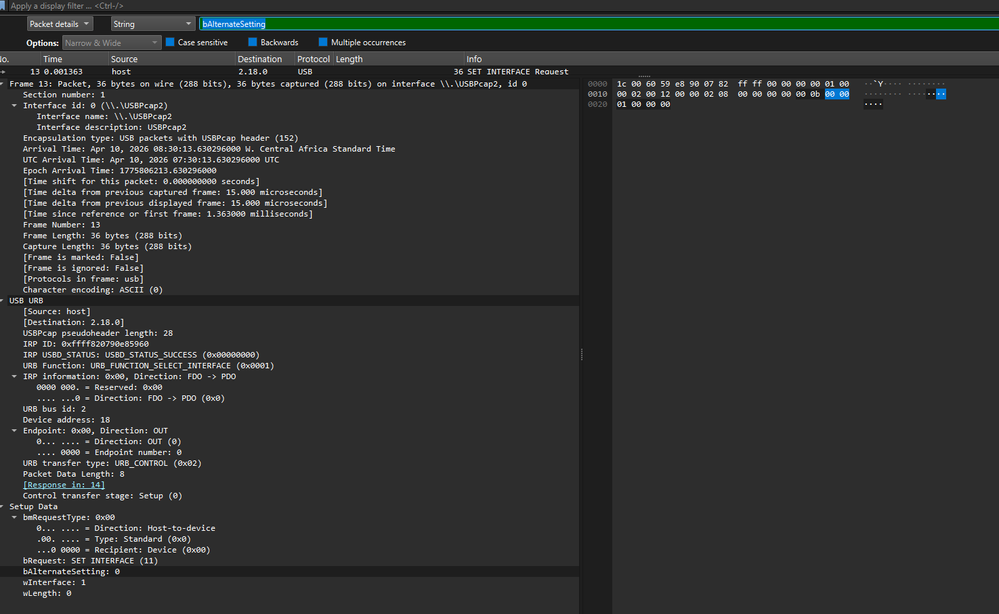

I made the change, but unfortunately only the CDC is visible in the Windows Device Manager.
I've attached a Wireshark capture.
What checks can I perform?

FBL
bAlternateSetting is still zero in frame 10 and 13
I'm suspecting something missing in composite builder class. Let me check and get back to you.
