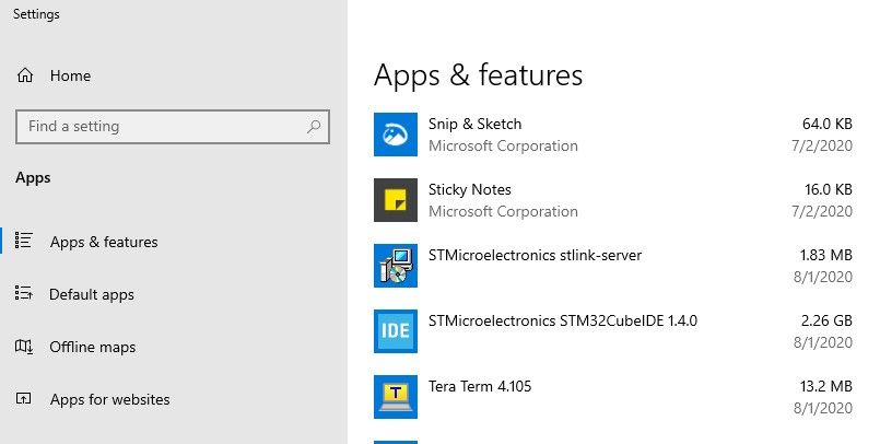

Hi, I have STM32L4S5 (STM32 Discovery Kit - IoT mode), Part number: B-L4S51-IOT01A.
https://www.st.com/en/evaluation-tools/b-l4s5i-iot01a.html
This is the first time I am using this device.

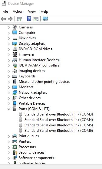

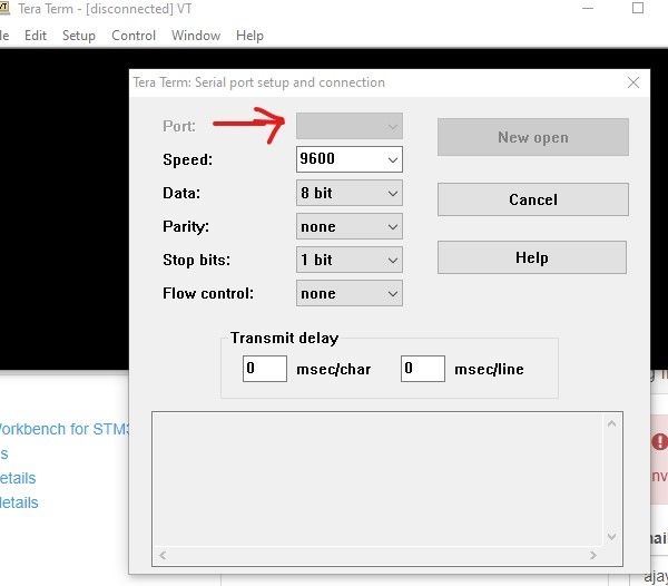

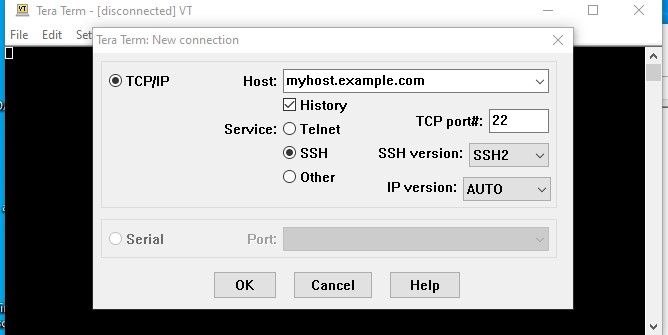

When I plug this device into Windows 10 machine, I am not able to connect to the device. I do not see any COM port in Device manager and also Tera Term serial port option is greyed out.
I did install STSW-LINK009. I have tried this is 3 windows device and getting same issue.
I noticed that Red line is blinking on the board, while green light is stable.

Try a different cable. Charging cables won't work for data connectivity.
‎2020-08-01 9:53 AM
Changing cable helped. Thank you for your suggestion.
