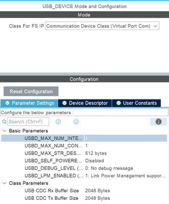

I attached my .ioc settings:
Do you have any other ideas?
