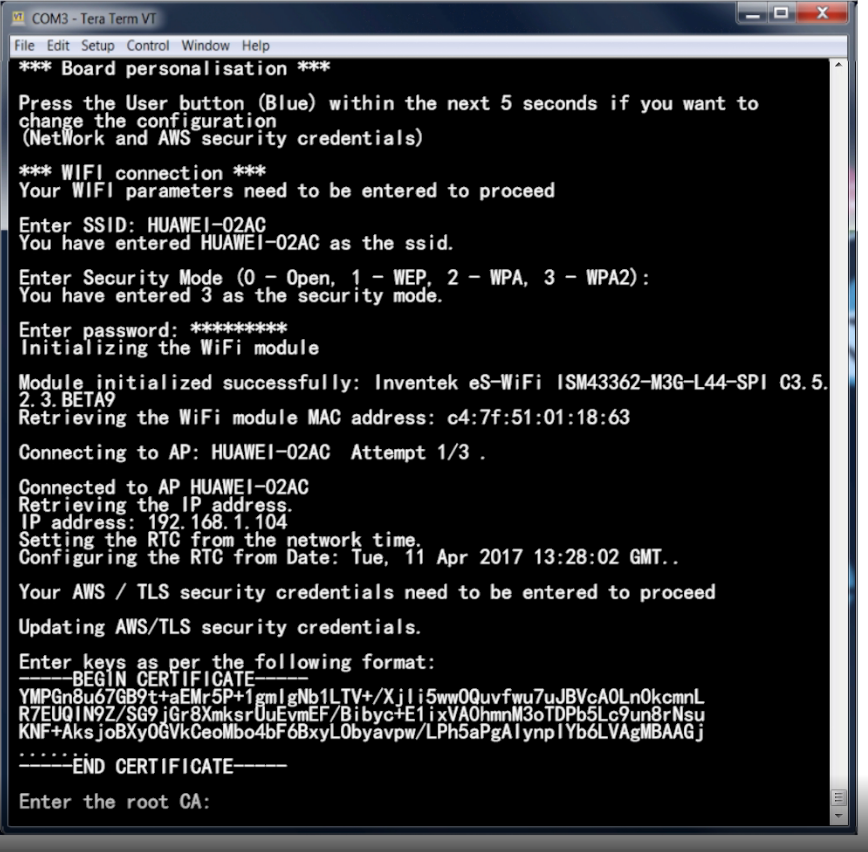

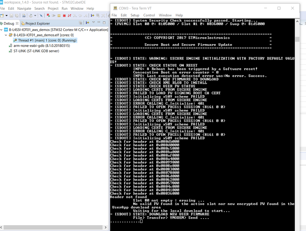

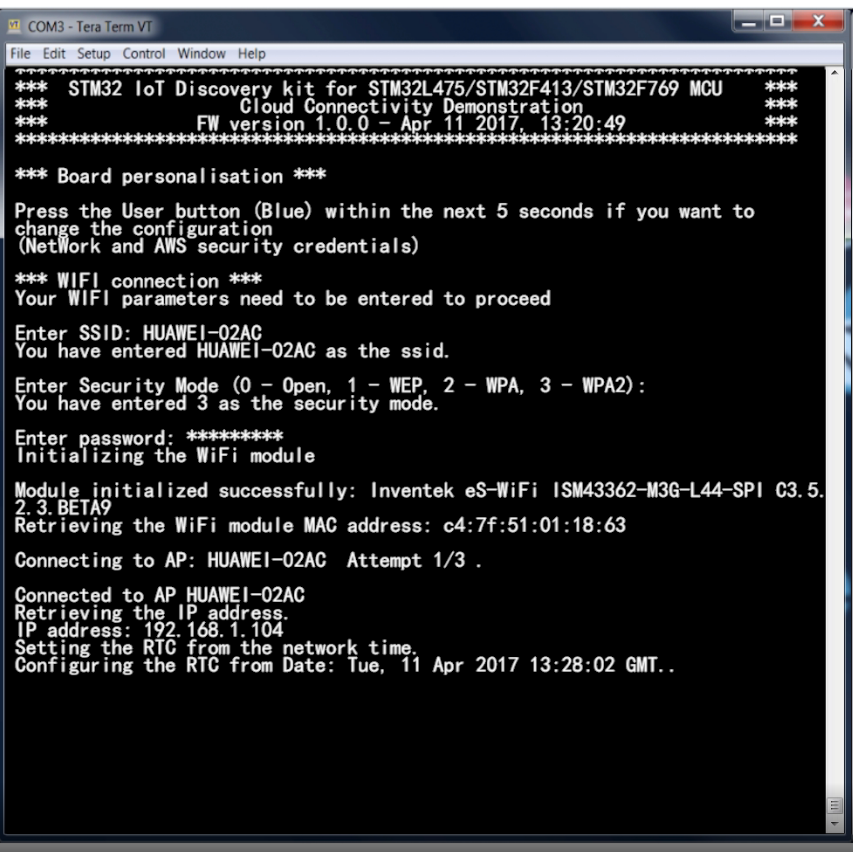

I had initially some issues connecting kit with UART terminal and tried few examples. With this I have lost pre-installed initialization steps to connect the kit with AWS.
Initial setup start with Wifi setup and them asking for AWS / TLS security credentials.
I would like to get the below screens for AWS.
here is screenshot when i run aws demo application
I would like to get the intial screen as shown in this video at 5:00 (attached screen as well)

Hello
try to do a full chip erase with STM32CubeProgrammer (in "Erasing and Programming" / "Erase Flash memory" / "Erase full chip").
then flash the X-CUBE-AWS .bin file with CubeProgrammer.
In the X-CUBE-AWS 1.4.x sources there is a pre-built firmware .bin file under Projects\B-L475E-IOT01A\Applications\Cloud\AWS\Binary\SBSFU_B-L475E-IOT01_Cloud_AWS_V1.4.0.bin
if you compile with System Workbench it's under Projects\B-L475E-IOT01A\Applications\Cloud\AWS\SW4STM32\PostBuild
