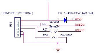

I'm currently working on stm32l053 VCP. I've done a code to initialize & start VCP driver in stm32l053 and tested it using stm32l053-DISCO board, where it works fine. I can able to detect the com port in my pc(I've downloaded & installed the VCP driver from ST).
When i flash the same .bin file to my custom board i'm unable to detect the VCP in my pc. I've used the same circuit provided in the stm32l053-DISCO Schematic for my custom board. I can see voltage at USB point 4.95 V and MCU is powering on at 3.56V and Vdd USB at 3.46 V. I don't know what i'm missing in my custom board. Could anyone please help me with this issue.

Hello!!
Is your board feeding from usb port itself? or from another external source?
In first case , put some milliseconds(10,20,..) delay before you initialize your usb port.
You wrote 'I've used the same circuit provided in the stm32l053-DISCO Schematic' You mean only about usb cirquit?
Check if VDDA, VSSA VDD_USB, BOOT, NRST pins connected as the other board.
‎2017-07-29 6:01 AM
Hi Vangelis,
Thank you.. It's working now. I didn't connected the USB_DP & USB_DM pins correctly, I swithced it instead.
