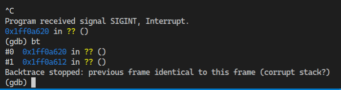

I'm having trouble entering the DFU bootloader on my H743 (rev V).
power on (with BOOT0 high) -> USB DFU functions as expected
power on (with BOOT0 low) -> application functions as expected
reset (with BOOT0 low) -> application functions as expected
reset (with BOOT0 high) -> DFU bootloader doesn't work
jump from application to DFU -> DFU bootloader doesn't work
I've tested this behavior both on a custom board (H743ZI rev V), and on a Nucleo-H743ZI2 with the same results. If I break in to the debugger in either of the not-working scenarios, I can see the program counter is in the bootloader's code somewhere, so it *is* jumping in, but USB doesn't work.
Jumping from application to bootloader works fine with the same application running on various F4 and F7 devices, but doesn't work on the H7.
What's going on? Why can't I enter the bootloader except at power-on?

I can pretty much rule all those out. I know it's actually entering the bootloader (wire/button works fine), since I can break in in the debugger and see it running.
Likewise, I'm sure the cable is fine because USB works fine while running the application (ie, not bootloader). PC isn't ignoring it due to something previous, because I can power on the device, reset to DFU, then connect USB, and the behavior is the same. dmesg shows no new USB device.

I did a bit of reverse engineering with Ghidra + GDB, and there's a function with a big loop that checks, in sequence:
- FD-CAN
- I2C1-3
- SPI1-4
- Check if something is happening on the RX bit in GPIOB - USART1 alternate mapping (if so, switch the alternate function mapping for USART1 to PB14/15)
- USART1-3
- Check if a struct in RAM contains a particular value (USB :))
(curiously, this doesn't match the order of checks in AN2606 :o)
In the USB OTG interrupt, that same struct in RAM is set to contain the "cable present" value. But that condition is never happening, so USB isn't getting initialized for whatever reason.

The plot thickens! I disabled USB in our application, so now it can't talk to the PC, but it's still fully alive. Created a thread that just waits a few seconds, then reboots to DFU (one of the things that didn't work before). Reset-to-DFU now works just fine. What the heck ST? A system reset is supposed to reset the system as if you'd powered it on, right? How is state spilling around a reset?
