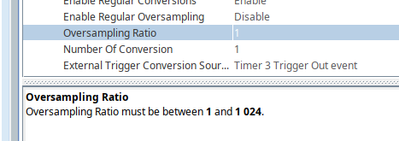

Just a question: you just summing the adc results , for average or better resolution ?
Why not use the ADC , let him make the sum : by oversampling ?
Or using the DFSDM , to get a filtered average ?

You are right. my problem is that I don't want all the samples, just part of them.
regarding the DFSDM - Can I use it to sum just part of the samples?
