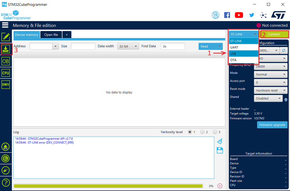

These are the steps to use this tool to use DFU bootloader on dual core (see screenshot):
0- Connect your USB FS of the board, connect BT0 to VDD and push reset.
1- From the menu select USB instead of STLink (default option)
2- Click "Connect" button.
3- Browse and select the hex file you want to download.
Normally you can do any handling on OB or the Flash.
So you can download either CM7 program or CM4 program binaries with this manipulation.

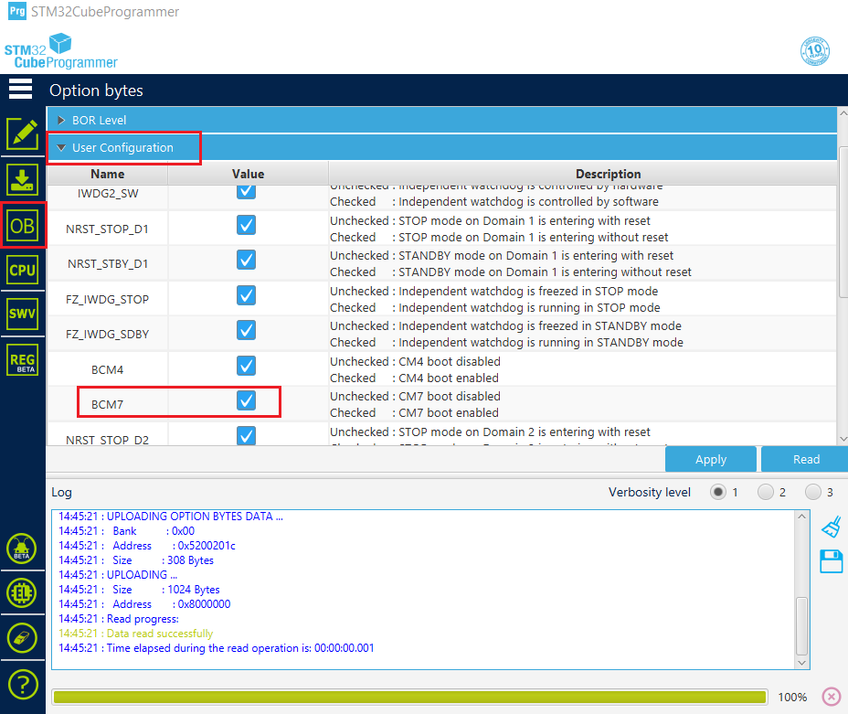

Note that you can do this operation only if the cortex-M7 boot is enabled in option byte as it's the only the core that runs the bootloader:
0693W00000BdgHGQAZ.pngHope this answers your question. If it's the case, please click on "Select as Best" this answer.
