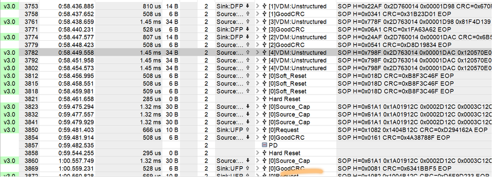

Used UCPD module to transfer UVDM packets. After some time, the UCPD module is not transmitting and receiving the data. For reception we have enabled RXMSGENDIE , RXNEIE and RXHRSTDETIE interrupts. for transmission ,we have enabled TXISIE , TXMSGSENTIE and TXMSGDISCIE interrupts.The UCPD module recovers after multiple hard reset. Used Non Blocking prints in the UCPD interrupts we didn't see any TX/ RX during this issue. We are not using DMA for this process.
Controller: STM32G474RETx
Kernel Clock: 150 MHz
Device Role: Sink
Regards,
Alagesan M

2021-08-10 12:30 AM
Dear @Community member
Could you please provide a .cpd log as described in our wiki page?
Thanks
Yohann
