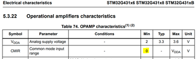

> Each one ranges from -100mV to +100mV.
No, this isn't possible. The OPAMP can't accept inputs below VSS.
‎2023-09-11 7:23 AM
Hello MasterT,
Thank you for your response. Would the OPAMP be able to read negative voltages in inverted mode? This is in reference to TDK's comment that the OPAMP can't accept inputs below 0.
Thanks
‎2023-09-11 8:09 AM
Yes, inverting mode accepts negative voltage, since input signal is driving resistive matrix and OPA inputs stay at +100 mV. There is schottky diodes on any inputs of the IC, including digital and analog inputs, but I think all should be fine for about -200mV, if more negative voltage is presents than external R is a cure in series with inverting input. Gain 'd be different, but easy to calculate /recalibrate
