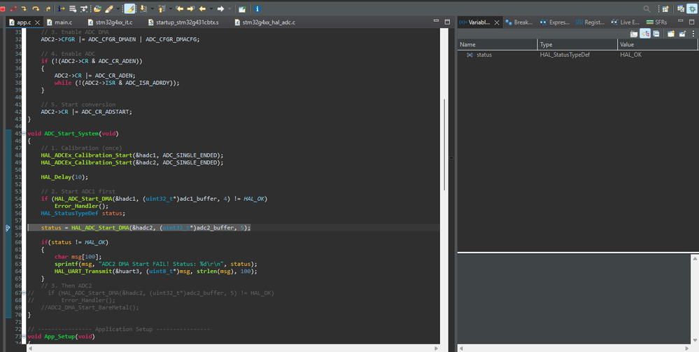

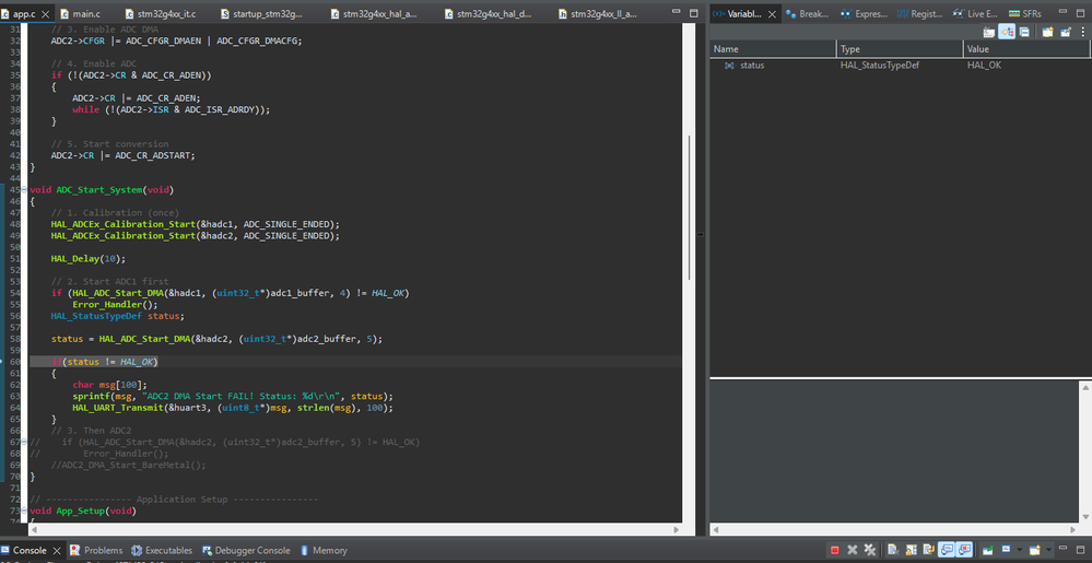

You didn't set the break point at the right line.
I said in my previous post, set it at if(status != HAL_OK) / line 68
HAL_ADC_Start_DMA()  is not yet executed when you set the breakpoint at line 58!
If it's stuck in the call, good luck getting a breakpoint after the call to be hit.
As suggested before, let it run, hit pause, see where it's at. Probably in an interrupt. Probably because you're converting too quickly. Slow down the sample rate.
So, the status is OK for ADC2.

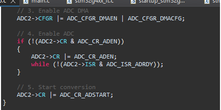

I have written a bare metal function for testing , This is my bare metal function . Its working fine . I have not call this function during your test.
void ADC2_DMA_Start_BareMetal(void)
// 1. Disable DMA
DMA1_Channel2->CCR &= ~DMA_CCR_EN;
// 2. Setup DMA
DMA1_Channel2->CPAR = (uint32_t)&ADC2->DR;
DMA1_Channel2->CMAR = (uint32_t)adc2_buffer;
DMA1_Channel2->CNDTR = 5;
DMA1_Channel2->CCR =
DMA_CCR_MINC
| DMA_CCR_CIRC
| DMA_CCR_PSIZE_0
| DMA_CCR_MSIZE_0;
DMA1_Channel2->CCR |= DMA_CCR_EN;
// 3. Enable ADC DMA
ADC2->CFGR |= ADC_CFGR_DMAEN | ADC_CFGR_DMACFG;
// 4. Enable ADC
if (!(ADC2->CR & ADC_CR_ADEN))
ADC2->CR |= ADC_CR_ADEN;
while (!(ADC2->ISR & ADC_ISR_ADRDY));
// 5. Start conversion
ADC2->CR |= ADC_CR_ADSTART;
