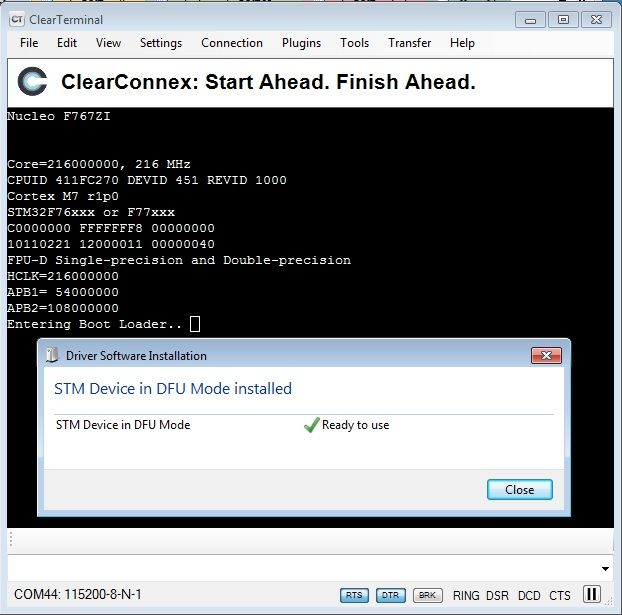

Ok, so confirming the F769I-DISCO is problematic, it doesn't have a USB-FS port, and the VCP on USART1 is not viable, likely due to the number of pins on the device and their assorted states. The USART should auto-baud via a TIM measuring the 0x7F pattern.
I was able to use the USB-FS on the NUCLEO-F767ZI
