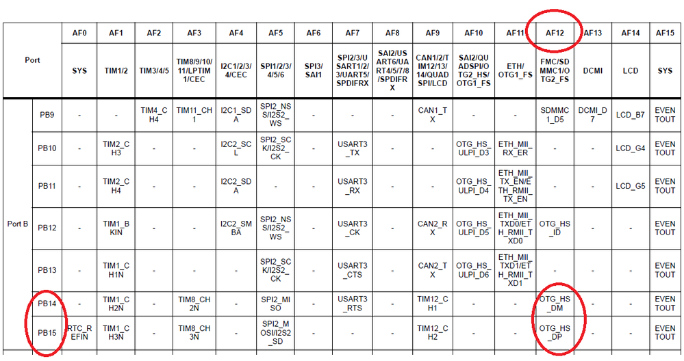

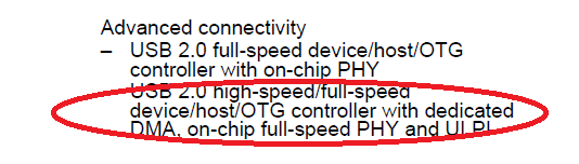

Khouloud GARSI
Posted on July 04, 2017 at 12:11
Hi
thakur.sushant
The STM32F746 and the STM32F439 devices embeds a:
  • USB 2.0 OTG FS = USB 2.0 FS device/host/OTG controller with on-chip FS PHY.
  • USB 2.0 OTG HS = USB 2.0 FS/HS device/host/OTG controller integrating the transceivers for FS operations and features an ULPI for HS operations: An external PHY device connected to the ULPI is required.
  1. If you want to perform HS operations, you need to add an external HS PHY.
  2. You may perform FS transfers:
  • On PA11/PA12 via the first controller described above.
  • On PB14/PB15 via the second controller described above.
I assume that, for your application, you want to use the second controller in FS mode. Thus, you should use PB14 and PB15 pins.
You may refer to
http://www.st.com/content/ccc/resource/technical/document/datasheet/96/ed/61/9b/e0/6c/45/0b/DM00166pdf/files/DM00166pdf/jcr:content/translations/en.DM00166pdf
,table12, to have a complete idea about the alternate functions mapping on the STM32F746 devices.
GPIO_InitStruct.Alternate = GPIO_AF12_OTG_HS_FS;
Khouloud.
