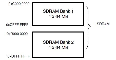

Posted on July 15, 2015 at 05:37
It's a secondary bank SDRAM so it lives at 0xD0000000 on the DISCO. The EVAL series board (STM324x9I-EVAL) it's the primary bank at 0xC0000000

Last, how do you know what is the start address for the external RAM? It is larger than the physical address that can be addressed using the available bits.
Posted on July 15, 2015 at 14:12
I've basically read and understood the manuals.
The Cortex-M4 has a 32-bit address bus, giving it access to a 4GB address space.
The SDRAM lives *within* this address space, the chip select in the logic surrounding the core recognizes the 256KB region between 0xD0000000..0xDFFFFFFF. The logic basically decodes, recognizes, the 0xD value in the high order 4-bits of the address on the bus, and directs traffic to the FMC/SDRAM.
I'm not familiar with WRITE?_READ?_ADDR(), is suspect it multiplies by 4 because you're accessing 32-bit words, which take 4-bytes, which are separate but contiguous within the memory space.
The memory map is described in the FMC/FSMC section of the REFERENCE MANUAL
