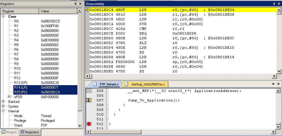

Now when debugging enter in the if condition but doesn't jump to the application, I had put a break point on Jump_To_Application and registers as image attached, but I don't know why this error still occur.

Posted on June 14, 2016 at 17:38
The registers without the assembler code it is executing really isn't going to tell me much.
What is the ''error'', you need to step through the code, probably in disassembly mode, and understand what it is doing, and what checks are being made. You'll want to step from the loader, into the application, confirming it goes and does what you've coded.

Posted on June 14, 2016 at 22:27
Ok, so it appears to have transferred control to the ResetHandler in the application, to some code that looks rather familiar
