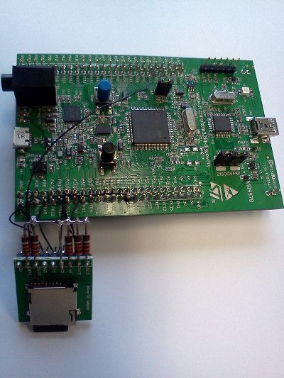

The Discovery is poor choice because it doesn't have any memory devices wired up to provide any of the ''Mass'' storage you aim to test, nor does it support High Speed USB (ie 480 Mbps), only Full Speed USB (ie 12 Mbps), with the obvious bandwidth limitations that comes with that.
The examples work well with the boards they are designed to demonstrate, less so with those that were not. You picked the Discovery because it was cheap, not full featured.

My current GNU release for the STM32F4-Discovery USB MSC for an external SD Card is attached to this post.
/public/STe2ecommunities/mcu/Lists/STM32Discovery/Attachments/2816/stm32f4_discovery_msc_sdhc_release_3.zip
