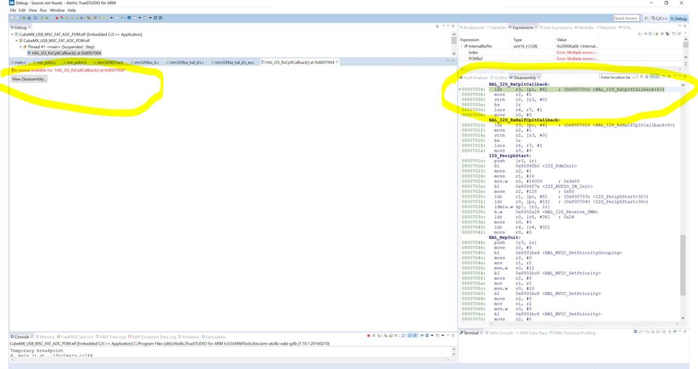

I am again working on my project. And during todays debugging i have found very strange behavior.

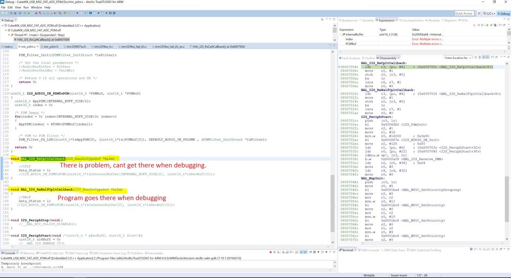

So in driver file''stm32f4xx_hal_i2s.c''
there are two functions that are setting up DMA Rx Callbacks:/* Set the I2S Rx DMA Half transfer complete callback */
hi2s->hdmarx->XferHalfCpltCallback = I2S_DMARxHalfCplt;
/* Set the I2S Rx DMA transfer complete callback */
hi2s->hdmarx->XferCpltCallback = I2S_DMARxCplt;
If i go to
I2S_DMARxHalfCplt()
it brings me to the same file''stm32f4xx_hal_i2s.c'' and this function is directly called
HAL_I2S_RxHalfCpltCallback(hi2s);
that is declared in my own .c file (it is weak ...) . This really works, this halp cplt callback is called and when debugging i get into my .c file where i define my version ofHAL_I2S_RxHalfCpltCallback(hi2s);

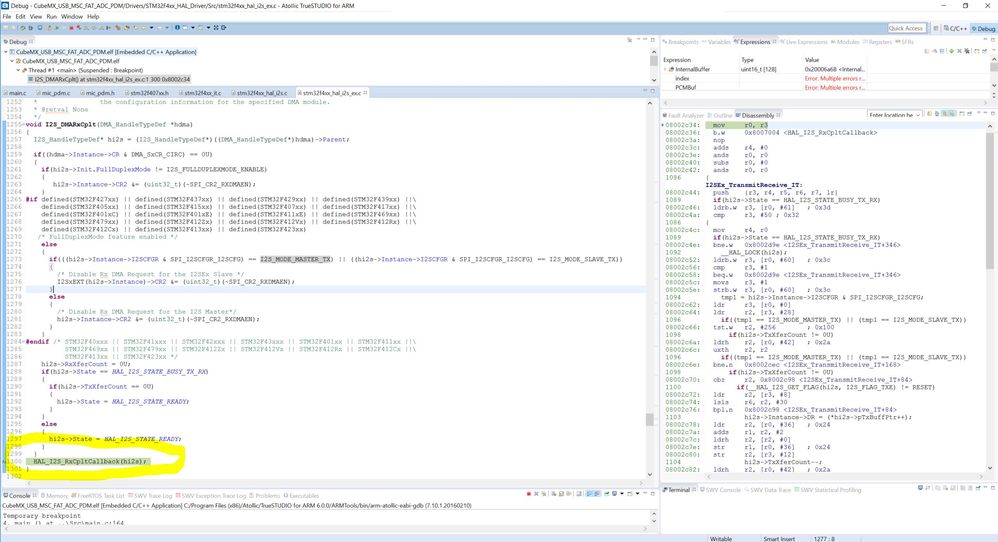

Problem is in case of
I2S_DMARxCplt()
. If i go to definition of that, it brings me to file''stm32f4xx_hal_i2s_ex.c''
. Here i can see some code lines (i guess it has something to do with handeling of buffer and so on) and at the end of function there isHAL_I2S_RxCpltCallback(hi2s);
. Great but when debugging, i get to this lineHAL_I2S_RxCpltCallback(hi2s);
and then program doesnt goes to my definition ofHAL_I2S_RxCpltCallback(hi2s);
, but it says ''no source code availible forHAL_I2S_RxCpltCallback(hi2s);
. When i look to disassembly, i can see that actually there is code for my implementation of that callback. So this is explenation why i never ''catch'' the code with breakpoint inserted to myRxCpltCallback
.Its like compiler would remove my RxCpltCallback, but in disassembly i can see it.
Any Ideas? Thanks Jan
‎2016-12-12 2:32 AM
Ok so now both callbacks stops when breakpoint is inserted. I needed to make both callbacks different, so when i added ++Data_Status; to halfCplt now i can observe how both callbacks are comming alternately.

Probably code didnt went into the callbacks because compiler removed them during optimalization as it seemed to be unnecessary code ...
