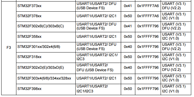

Imen.D
Posted on August 04, 2017 at 16:21
Hello
J.Prasant
CAN bootloaderis not applicable for STM32F
I recommend that you have a look to the application note ''STM32 microcontroller system memory boot mode''
http://www.st.com/content/ccc/resource/technical/document/application_note/b9/9b/16/3a/12/1e/40/0c/CD001675pdf/files/CD001675pdf/jcr:content/translations/en.CD001675pdf
and you find related information to the STM32F303 bootloader .
You can refer to this
http://www.st.com/content/ccc/resource/technical/document/application_note/56/94/0c/7d/63/f6/4d/96/CD00264pdf/files/CD00264pdf/jcr:content/translations/en.CD00264pdf
''CAN protocol used in the STM32 bootloader'' and checkApplicable products.
