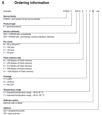

It could be a chip revision problem? What means the last letter 'U' on Nucleo Chip ? What means: "Software Option" on Ordering information code (see Figure) ?

The "U" suffix is a part number that is only found on ST boards. I believe it's due to a licensing issue, but it's the same chip as the non-"U" version and isn't the source of the problem. Lots of threads on this, none with definitive answers from ST as far as I can see.
