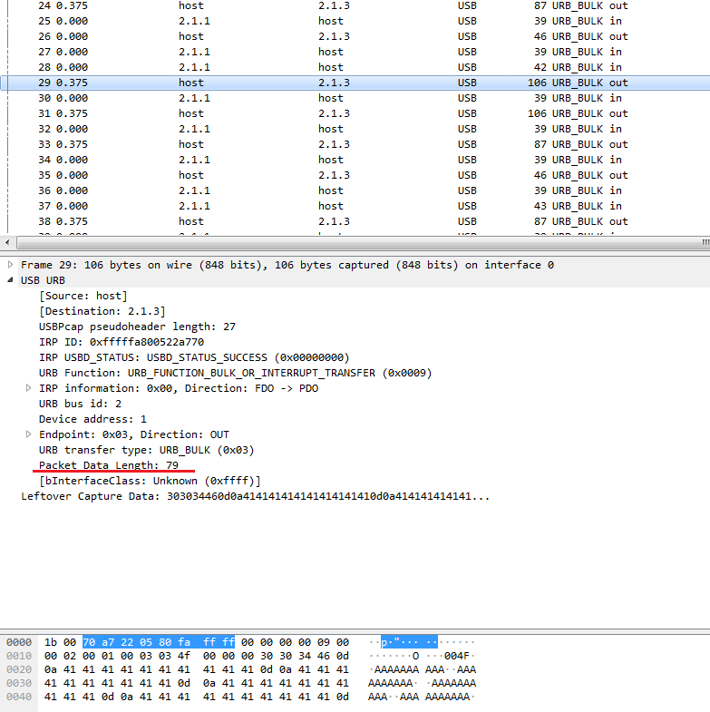

USB on the STM is configured for Bulk transfer, using 64-byte Receive_Buffer. So, according to USB specification, the host shouldn't send packets with length more than 64 bytes. But..

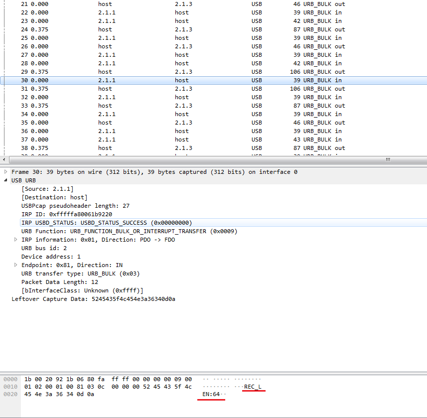

When I send data through USB to the STM, I'm also monitoring the bus with WireShark, and, on the receiving side, I wrote a simple counter data_size that counts the incoming data and then it's being sent back to the host at the end of reception. Also, I'm monitoring the Receive_length.
So, the issue is that everything works fine as long as the host sends packet of length no more than 64 bytes. But sometimes occasionally it decides to send more, for instance, 79 bytes: 0690X000009Yg4dQAC.png
And the STM responds with Receive_length = 64, i.e. it just cuts the data length resulting in data loss.
And, what's interesting, the USB on the STM's side doesn't raise any flags, like PMAOVR or whatever. It just cuts the data length, resulting in data loss.

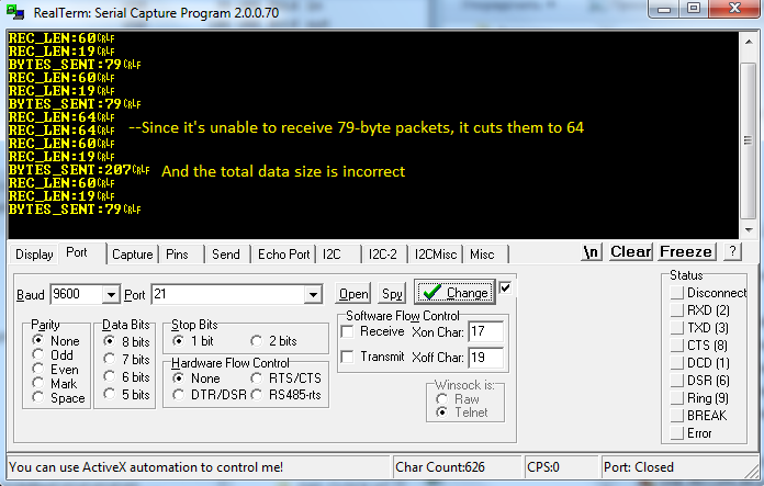

Here's what I see in the terminal:
I'm constantly sending a 79-byte file each 200 ms. Sometimes it works correctly, sometimes not.
