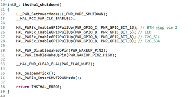

I'm trying to determine the source of the wakeup flag, whether it's the power being turned on or the trigger of wakeup pin 2.
So this is my shutdown function:

in this example, they check the register for standby mode first, but it's not the same case for shutdown.

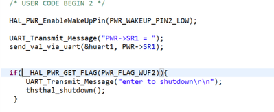

For me, the wakeup flag is always zero when I press the button (When the debug is disabled), whereas in debug mode, I receive pwr->SR1 = 258 when I press the button.
