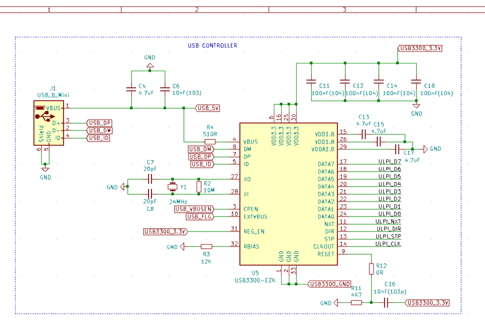

I am in the process of power on my custom board.
Right now I'm trying to get the USB to work but I'm stuck and don't know what to do next.
I use USB midleware from CubeMX 6.1.2
The moment I have everything configured and run the interrupts I get the one interrupt with flags:
USB_OTG_GINTSTS_USBRST and USB_OTG_GINTSTS_USBSUSP.
While handling the suspend handler my micro controller is restarting
(The restart is caused by operation: __HAL_PCD_GATE_PHYCLOCK(hpcd) in usb suspend handler)
I checked the voltages and waveforms of crystal lines and ulpi clk line and everything seems to be ok.
Here is the USB3300 wiring diagram:
0693W00000D1pcUQAR.pngThanks
Piotr
Someone already stated on this forum that if something went wrong with USB330 it was HW's fault . I tested 4 USB3300 controllers and only the 4th one worked.

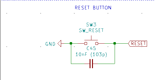

How is your NRST wired? Do you have a 0.1uF cap on it? Maybe using a scope on the NRST signal would prove insightful. Not really sure what it could be.
This is what the NRST line looks like
Keep in mind that the uC restarts in a loop. Those longer pauses were when I pressed the reset button.
I have a 10nF capacitor there:
I changed the condenser at reset to 0.1uF - no change seen.
As for the interrupt: While I understand the reset flag, is this suspend flag normal ?
One more thing wonders me. How can I check if everything is ok with ext phy USB3300?
As far as I know that the uC is ok because I can communicate with it, how can I check it for USB3300. Can I use the uC to try to read some USB3300 registers or something?
