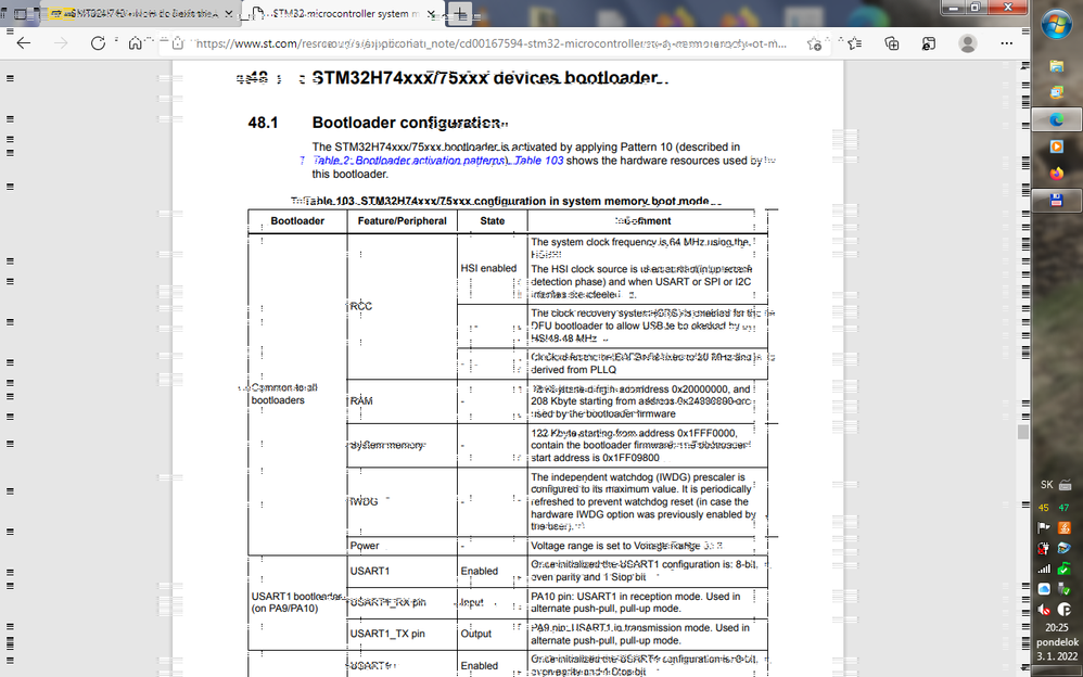

Every MCU have own start addr and you use bad
0693W00000HqRWLQA3.pngstart address is 0x1FF09800

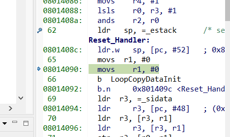

Thanks for the link. That worked to get my program to jump directly to the bootloader. But now I send the GO command and I'm still in the bootloader. I am trying to jump to 0x0801408c per the disassembly, but nothing happens. I confirmed that the GO command is being ACK'd.
EDIT - It seems like the debugger was messing with the operation somehow. When I program and disconnect before invoking the bootloader, then jump to this reset address, everything works fine. Thanks for the help!
Thanks. I must have an old copy of AN2606 as mine does not have the line. It just states that the system memory starts at 0x1FF00000, but nothing about the bootloader being at 0x1FF09800.
