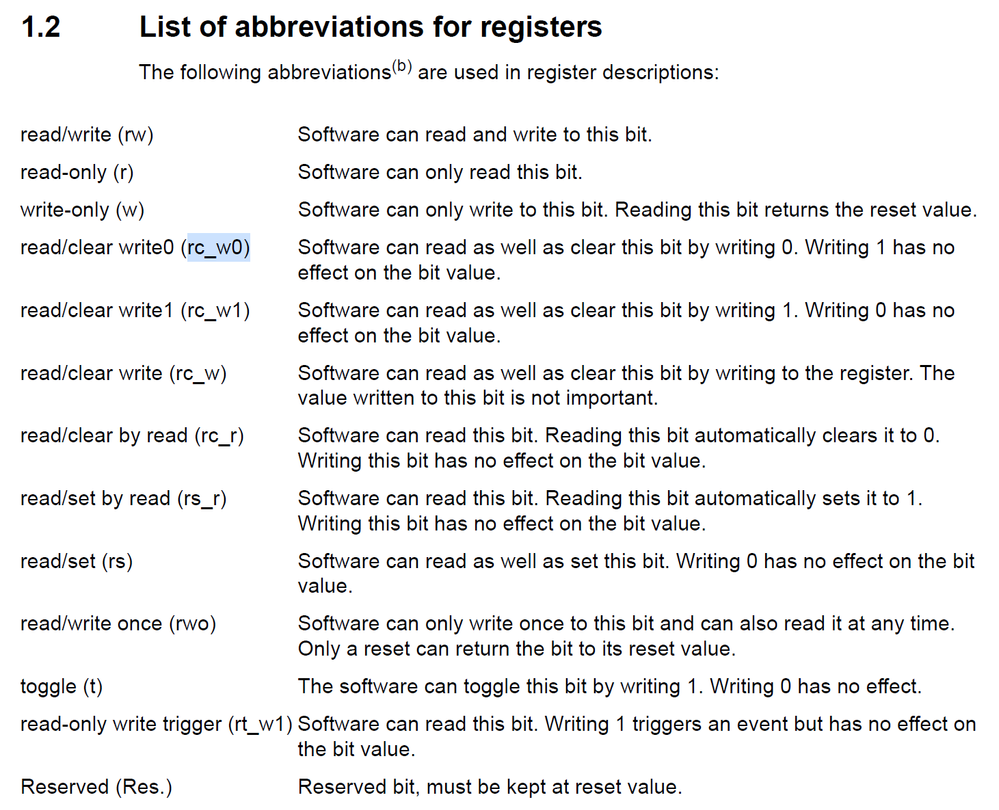

read-modify-write is not atomic. If a flag is set mid-way through that process, you will clear it without knowing.
It isn't an issue in this example, but RMW is unnecessary here and can bite you.
I don't clear any other flags than UIF. I don't affect them in any way. Whatever was 1, will stay 1. Whatever was 0, will stay 0. I don't see any problem. Can you provide a detailed example of something going wrong and how do you suggest I should do it instead.
Edit: I think I know what you mean after a little consideration. Indeed. I see it. Still, how do I fix it then? Your proposed solution looks plain wrong as it sets all 0 flags to 1
Checked the reference manual. The bits in status register are rc_w0. What exactly does it mean? (I take it it's OK to write smth there, but I want to know the definition of that thing to understand it)
"rc_w0, meaning software can write a 1 with no effect, or write a
0 to clear a particular status." Ok. I understand your answer! I got why you're right about everything. Thanks!
Glad you understand. It is a minor point but it can get you when you're doing more complex stuff.
Flag clearing on the various peripherals can vary so it's good to check the reference manual for the exact method to clear them, especially if you are doing register-access and care about speed.
Definitions for the various registers are in the beginning of the RM:
