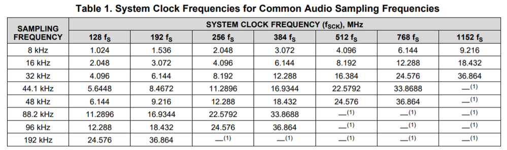

How do I get the best audio clock accuracy using the separate SAI PLL without fiddling manually with all the values?
The SAI clock should be one of these, or as close as possible to be accurate:
I tried just entering the value in CubeMX but clearly it is not possible to get exactly those values so CubeMX cannot manage.
What I would like ideally is a simple way to say I want fs=44.1kHz audio freq for ex and then the tool tries to get a SAI clock as close as possible as one of the possible frequencies (128fs, 256fs, etc.).

Well, you start with a crystal appropriate to the task, i.e if you want 44.1kHz, you get a multiple of that, and not any integer-multiple-of-MHz one.
There's also a dedicated clock input for I2S/SAI, for a reason.

Yes, the I2S clock input would need an oscillator. Some audio ADC/DAC/codecs do have integrated oscillator, even fractional-PLL; there are also standalone oscillators, sometimes integrated with PLL, too. I don't say they are cheap, but they are convenient.
Maybe you can pull this out using the HSE oscillator, but first, make priorities. In audio product, it's probably the audio you want to be the most precise. It may be possible to find a solution to generate both the 44k1 and 48k range of frequencies from a single crystal. I'm not going to find it now. Then, prioritize according to required precision (USB-USART-whatnot; system clock as such is probably the least important although that's what most calculators aim at primarily) and try to find the combination of multipliers and dividers to get as close as possible.
waclawek.jan
For example:
6.144MHz / 5 * 147 / 16 = 44k1 * 256
6.144MHz / 5 * 100 / 10 = 48k * 256
6.144MHz / 4 * 125 / 4 = 48MHz
6.144MHz / 4 * 234 / 2 = 179.712MHz

Wow I am literally blown away, this is amazing!! :D
For some reason I was stuck in the world of 8/16/25Mhz crystals, that opened a whole new world! :)
Yes I was thinking ideally avoid the costly external oscillators, and avoid the very probably price raise of the DAC if I want it to have integrated oscillator (the one I chose is cheap and does not have one).
And yes indeed the project will use USB + SDIO + FSMC display (I have not really looked into this yet but I guess this will not require a special clock) and I'll also need a UART at 31.250kHz but that is quite low so it should be possible to get very close with pretty much any config I think.
So basically you sorted it out for me - thank you so much for that - I am still wondering though:
1) how did you do it - just kinda guestimating the values here and there, testing and after some time found a value that works?
2) would it not be nice to have to tool to do that for us? I am literally thinking of making one.
Ok I actually have a partial answer to my first question - going there f.x.: https://en.wikipedia.org/wiki/Crystal_oscillator_frequencies actually gives a really good starting point as they mention which frequency is usually used for what :) That reduces a lot the amount of crystal frequencies to try with.

179.712MHz / 4 / 90 / 16 = 31.200kHz, the error is 0.16%, that should be okay.
I was already there, having worked with audio and 'F446. I had the luxury of having a dedicated high-quality oscillator on the dedicated I2S_CLK input, and also I didn't need to support 44k1... but I had the calculations done back then and just dug them out :) .
It's actually not THAT hard to write an ad-hoc tool for it. However, it's probably hard to polish it into anything universally usable.
Yes I know that table, but I actually go by the offerings in outlets like Mouser. For example, the least common denominator between 44k1 and 48k is 7.056MHz (that value is not in that table, but twice that is, 14.112MHz). However, these are fairly rare crystals.
