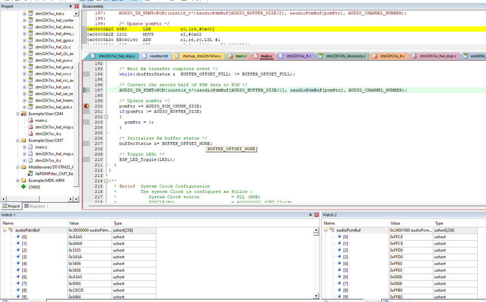

i tried the SAI_AudioPlayback example for the h745 discovery board. I'm using Keil and with the keil 5 armcc compiler everything works fine.
Now i switched to armclang 6 and replaced the "libPDMFilter_cm7_keil_wc16.lib" with "libPDMFilter_cm7_gcc_wc16.a" i can compile & run the program but soundoutput is not working.
i attached a screenshot. for the input i get pdm values but pcm is always zero. If i compile with armcc the pcm values are not zero.
is there something i have to configure? i think maybe it is some signed/unsigned problem? does anybody have a hint what can cause this error?

It's because of D-cache. Look at audioPdmBuf addresses - on the right it's located at a data/bss sections, while on the left it's at some dedicated memory region most likely configured in MPU. For testing purposes just do not enable the D-cache.

This is the debug output with the armcc compiler
The dcache gets invalidated by the program(it's the st example) and with armcc everything works fine so my conclusion was: it is something compiler related but maybe this is misleading?
(but i will check the dcache anyway because i'm not saddle-proof regarding this topic)
Start by adjusting the audioPdmBuf definition to get it to the same 0x38000000 address. For Clang it should be similar to GCC:
https://developer.arm.com/documentation/100067/0612/Compiler-specific-Function--Variable--and-Type-Attributes/--attribute----section--name-----variable-attribute

In the first post, the breakpoint appears to have stopped execution before actually calling AUDIO_IN_PDMToPCM() function, as consequence of debugging optimized code. If it was before the first call to that function, the output buffer might've been cleared from the startup code if it's a global variable.

on both screenshots i stopped in line 200 after the lib was called(the marker is the yello arrow, not the blue one)
on both screenshots the variable is placed at the same memory location @piranha!! so no! this likley has nothing todo with d-cache or anything(or it is something this lib needs to handle differently internal, which i doubt atm)
with armcc it works, with armclang not. (same code)
only thing changed is this lib because cubemx delivers other libs for each compiler compilers. and as said there were problems with other libs before because i think signed/unsigned behaves different iirc
