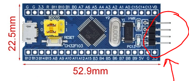

First you need to download the arduino packages for that st board.(if its supported)
Then once youre able to compile the code succesfully:
If my memory doesnt fail me you wont need to flash any pesky usb bootloader in your st board if youre using the STLINK with the SWD terminals.
Arduino bootloader normally uses the USB to flash your arduino IDE compiled firmware.
But there is also am option "flash using SWD" in which you use the swdio pins
(bluepill stm32f103 example)
0693W00000JMiOMQA1.pngconnected to an stlink flasher, the stlink could be from a nucleo/discovery board or bought standalone from ST.
