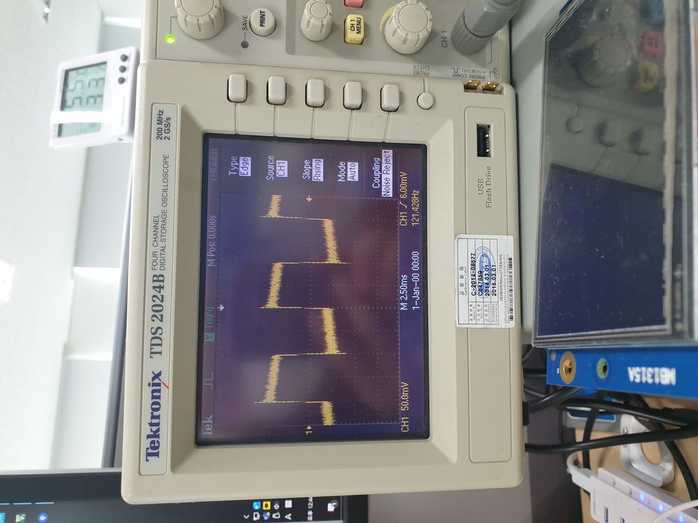

I checked data input and output of CS42L51.

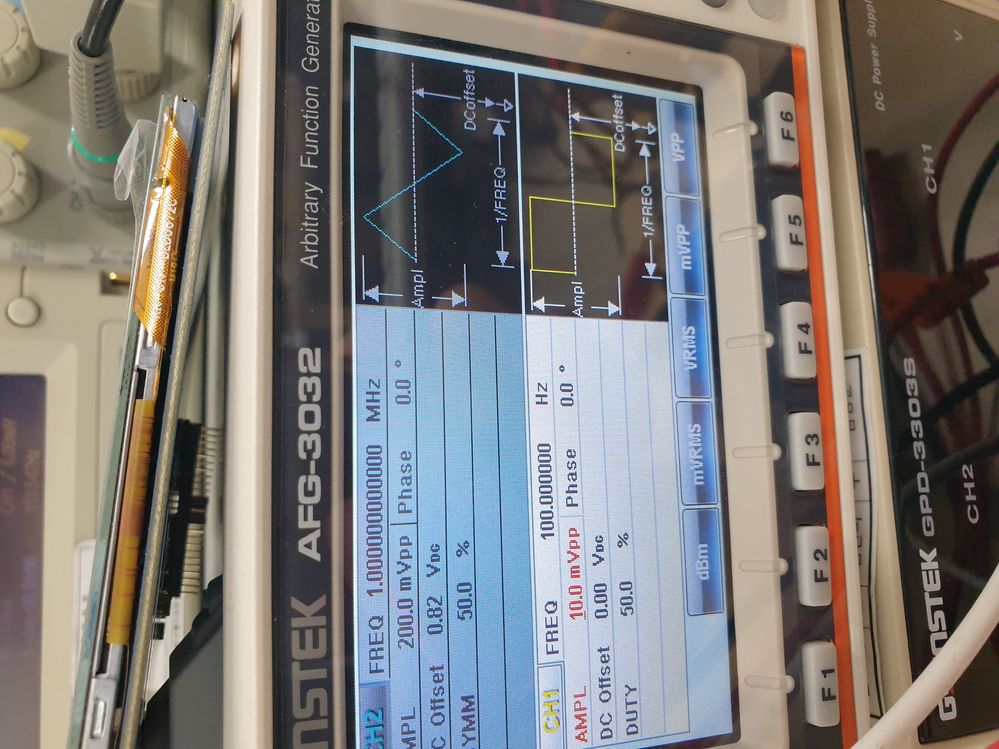

  • Input wave : 100Hz 10mVpp square wave(to CN6 Left pin)0693W00000LzPa0QAF.jpg
The SAI frame size is 64bit and slot size is 32bit.
SAI and CS42L51 work properly.

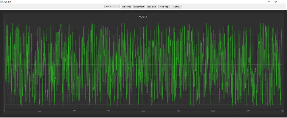

But, when i convert input data to integer value, the result was not square wave.
I sent data to desktop using uart. Below picture is result.

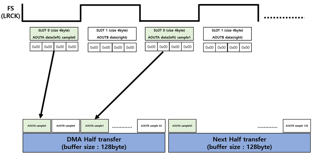

First question.
I think the dma and SAI buffer work as below.
Is it right?
Second question.
I sent 32bit 16k sample to desktop using uart.
  • 64bit(left 4byte, right 4byte) x 16,000 = 1,024,000bps = 1.024Mbps
I set uart baud rate to 1.5Mbps.
desktop os is windows 10 and i implemeted serial program using pyserial.
Is this baud rate enough?

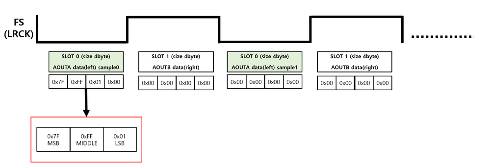

Last question.​
I convert 24bit data using below code.
def byte3_to_integer(value1, value2, value3):
    d1 = value1 & 0x7F
    d2 = value2 & 0xFF
    d3 = value3 & 0xFF
    result = (d1 << 16) + (d2 << 8) + d3
    if (value1 & 0x80) == 0x80:
        result -= 0x800000
    return result
Is there anything wrong in the process of converting sample?
