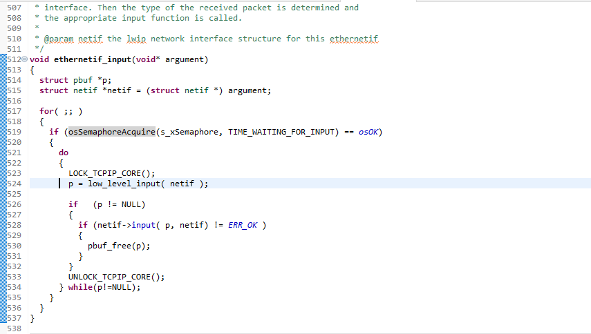

I am using FreeRTOS+LWIP on stm32f429zi. All working fine but after some time program control stucks at ethernet_input function. so due to this context switching not happens and other tasks gets affected.
I also tried the below solution obtained from forum, but not working this.

As can be seen on lines 523 and 533 in your screenshot, ST implemented the lock. They did it in a sub-optimal way, but functionally under typical configuration it works. Use one or the other, not both!
You probably already know:
https://community.st.com/s/question/0D50X0000BOtfhnSQB/how-to-make-ethernet-and-lwip-working-on-stm32
For F1/F2/F4 with RTOS the biggest offenders are ST's link detection and DHCP client code. It breaks lwIP's multi-threading rules and is just completely wrong.
