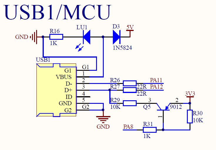

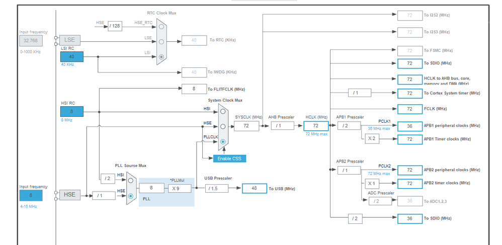

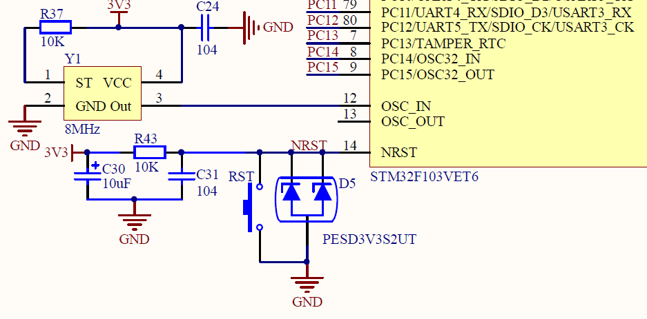

My board is also a custom made board with STM32F103VET6
The USB circuit
The clock circuit
The clock config.
I knew that the demo has no PA8 for pull up, so I added that in "usb_device.c" in "void MX_USB_DEVICE_Init(void)" before "if (USBD_Init(&hUsbDeviceFS, &FS_Desc, DEVICE_FS) != USBD_OK)" but not stable, sometimes (normally nothing happened) I managed to see the flash drive after running the debug mode several time but it gone after 1 or 2 sec.

Hi Simon
I am sure I have very inferior STM32 knowledge compared to many here. As far as I can see your clock configuration looks OK to me, for USB FS because you have 48MHz for the USB peripheral which is good. There are TWO things which I can immediately think of which may be causing your problem.
  1. The USB FS spec requires a 1.5K pull-up to 3.3V on the USB D+ signal. You did not provide that. On some members of the STM32 device family, the USB FS pull-up resistor is provided by the STM32 internally. On other members, it is not. I am using the STM32F401RBT6 and on this device there is an internal 1.5K pull-up resistor and so an external resistor is NOT required. However on the STM32F103 there is no internal pull-up resistor in the USB peripheral and therefore you must provide it externally. I have been bitten by this too, on a different project, that used STM32F103 on my own custom board! I was pondering that for a long time and found the answer with a bit of Googling. As soon as I added the 1.5K pullup to 3.3V, my problems disappeared. In your case you have a transistor switching it, which itself will cause a ~0.6V voltage drop from 3.3V; AND you are using a 10K resistor. I would recommend deleting that whole circuit and just use a 1.5K pullup to +3.3V. Do you really need to be able to switch it? If you really do, perhaps use a P-channel MOSFET to avoid the voltage drop (I don't know if the voltage drop causes a problem or not). But either way 10K is wrong, it should be 1.5K.

Hi Hans,
Thank you very much your advice.
Eventually I got that work perfectly.
I had changed the value of the resistor and switched on the pull up pin but it didn't work. However, I noticed that when I deleted the customized contents in "STORAGE_Init_FS", "STORAGE_GetCapacity_FS", "STORAGE_Read_FS" and "STORAGE_Write_FS" under "usbd_storage_if.c", my pc could detect the USB drive but it asked me to format the drive, then I understand the drive didn't show up because of the problems of my custom code ! I did some google search again and found one example to the drive perfectly. I can have a good sleep tonight.:D
