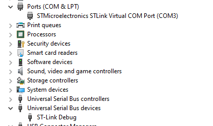

 4. Driver Installed :
   en.stsw-link009 and Virtual Com port : VCP_V1.5.0_Setup_W8_x64

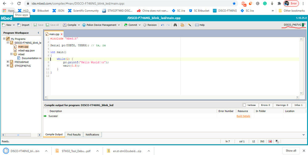

5. Coding Using MBED online compiler.

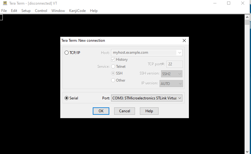

Issue : When I access COM3 port using Tera Term / putty it shows me blank screen,
Why it don't print Helllo World on putty or Teram Term console ???
But On this board I can run LED blinking programs successfully.
Code :
#include "mbed.h"
Serial pc(USBTX, USBRX); // tx, rx
int main()
  while(1) {
    pc.printf("Hello World!\n");
    wait(0.8);
Kindly refer below screen snaps of Virtual Com Port, Tera term and Code for more detail.

Check that your port settings match on both sides. Probe the lines to make sure a signal is actually sent.

@TDK​ : Kindly elaborate what exactly I should do to port settings match on both sides ? I spend lot of hours in fixing this issue.But not able to find any fix for it.
July 8, 2020
You'll need to dig into the documentation of whatever software you're using. It's not clear if Serial is using a UART port to talk to the ST-Link or if you're using the USB itself to act as a VCP. I suspect it is the former, in which case the baud rate, data bits, parity and stop bit settings need to match on TeraTerm and within your STM32 UART initialization.

I tried with baud rate 9600 and 115200, But it don't work for me.
Any more suggestion ?
