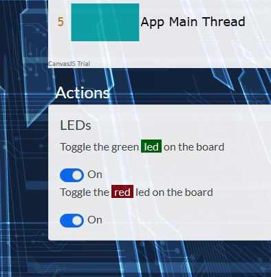

I successfully added controls to enable blinking the red LED controls. I also create a RedLedThred in Nx_WebServer app to blink the red led. Now both LEDs (green+red) can be enabled to blink from website.

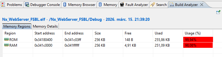

However, the memory usage looks very bad:

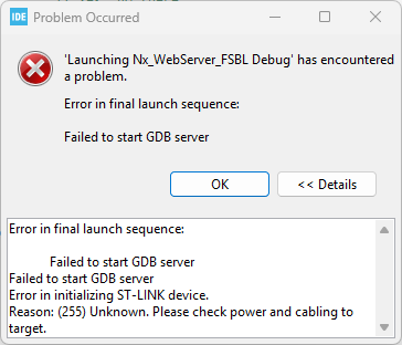

Debugging is also a problem. The only way to debug the app to set BOOT1 switch to 1-3 (right) position, do not run the SingAndLoad.bat, but start debugging. This works fine.
If you set BOOT1 switch to 1-3 (right) position, do run the SingAndLoad.bat, set BOOT1 switch back to 1-2 (left) position, cycle the power then the app runs, but starting the debugger reports Failed to start GDB Server error:

MEMORY
  ROM    (xrw)    : ORIGIN = 0x34180400,   LENGTH = 256K
  RAM    (xrw)    : ORIGIN = 0x341C0000,   LENGTH = 256K
/* Sections */
SECTIONS
Any idea, anybody?
Thanks,
Louis
