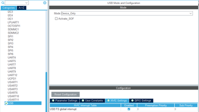

Once the project creation is done, enable the USB peripheral [USB] peripheral in device only mode, located in the [Connectivity] section.

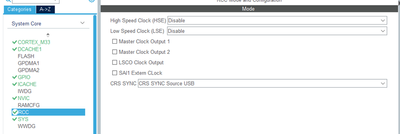

Enable the [CRS SYNC SOURCE USB] option in CRS SYNC, located in the [RCC] section.

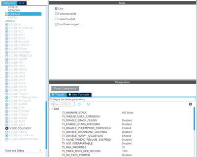

Enable the [CORE] in THREADX, located in the [Middleware and software packages] section.
Increment the [TX_MINIMUM_STACK] to 800 bytes.

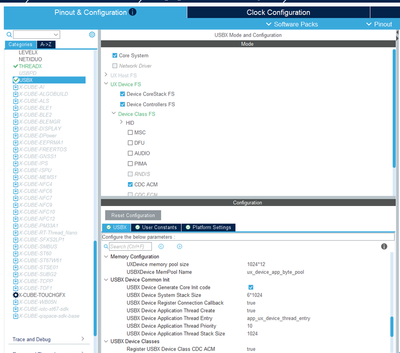

Enable the [Core system] [Device CoreStack FS] [Device Controllers FS] [CDC ACM] in USBX, located in the [Middleware and software packages] section.
Change [UXDevice memory pool size] to 12*1024.
Change [USBX Device system Stack size] to 6*1024.

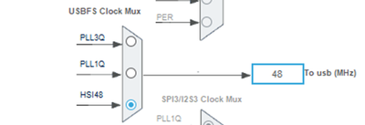

In the [CLOCK CONFIGURATION], just ensure that the USB is getting a 48MHZ signal.

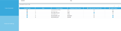

In the project manager, select advanced settings and fill the options like this.
Now, name your project and generate your code.

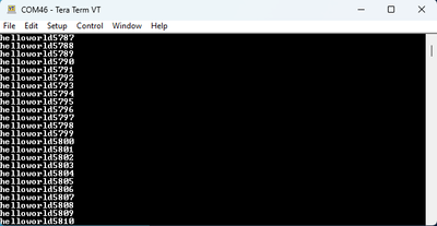

2. Results

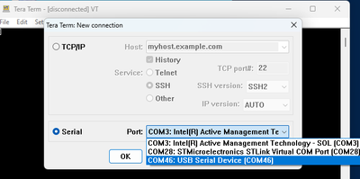

After flashing the code, connect a USB Type-C® cable into the user USB connector and connect it to a computer. Open a virtual COM port terminal in your computer.
An incrementing “Hello world” message must appear in the serial monitor view.

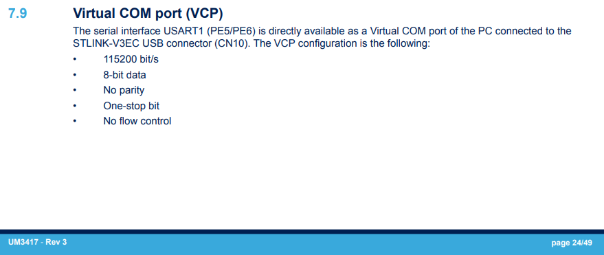

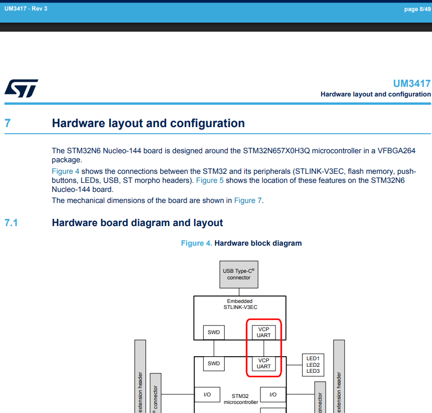

As it's on a Nucleo board, why not just use the Virtual COM Port (VCP) built into the ST-Link ?

Here all the code implementation is done! You can build and flash the code into your device and try it!
2. Results

I don't know how to use ST LINK to transfer data to PC, because it's work is supply power for STM.
It provides a Virtual COM Port (VCP) connected to one of the UARTs on the Target STM32N657x0q.
It is the simplest way to get data to a PC - no need to mess about with implementing USB and CDC yourself in your code.
Details are in the User Manual for the board:
https://www.st.com/resource/en/user_manual/um3417-stm32n6-nucleo144-board-mb1940-stmicroelectronics.pdf
via: https://www.st.com/en/evaluation-tools/nucleo-n657x0-q.html#documentation
